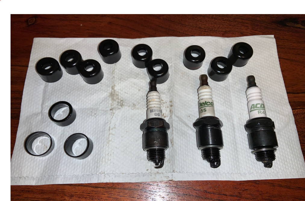

I would start by replacing your valve seals. I had similar symptoms to yours on my stock 327/300 engine: My '67 coupe was blowing blue smoke upon start up and was using about a quart of oil every 6-700 miles. The #2 and #4 spark plugs would foul quickly, leading to loss of power. The car had an unstable idle that I thought was carb related. Replacing the fouled plugs would restore performance and idle quality, but only for as long as it took for the plugs to foul again. The engine had 91,400 miles and was completely rebuilt in 1990, including multi-angle valve grind and new valve guides. When rebuilt, the engine had 74,000 miles on it, and had traveled about 18,000 miles since being rebuilt.
It was suggested that the valve guides were worn, allowing oil to drip into the cylinder and foul the plugs. The fix would be to remove the cylinder heads and have them reconditioned with new valve guides etc. Not a cheap fix.
I decided to begin by replacing the valve seals. That fixed all the problems, and the car ran better than ever! The old umbrella seals had become rock-hard and several had disintegrated.
I suspect the internals of your engine are fine. Start by replacing the valve seals and see if this fixes your problem.

Last summer I noticed the engine starting to use more oil. I’d also see blue smoke upon cold start. Two of the 8 plugs would regularly foul with oil. Replacing the bad plugs would restore performance, but only for a few hundred miles until they fouled again. This pointed to worn valve guides or valve seals as the culprit.
Yesterday I had a shop replace the valve seals with the heads on the engine. The job took about 5 hours. The only thing found on the valve stems were black hard plastic umbrella seals! Of the 16 umbrellas, 9 were intact and 3 were missing their top portion. Four umbrellas had disintegrated, with smaller pieces lying about the lifter gallery. There were no O-rings installed on the valve stems.
The mechanic cleaned out the broken umbrella pieces and installed FelPro SS-5112 ‘O’-rings and FelPro SS-10058 umbrella seals, this as recommended by Joe Fisher in his excellent photographed procedure (Thanks Joe!)
Result – no more blue smoke on startup, a steady idle with 19” hg of vacuum at idle, and smoother power delivery on acceleration! I’m thrilled that my Sting Ray is finally performing as a Corvette should!
