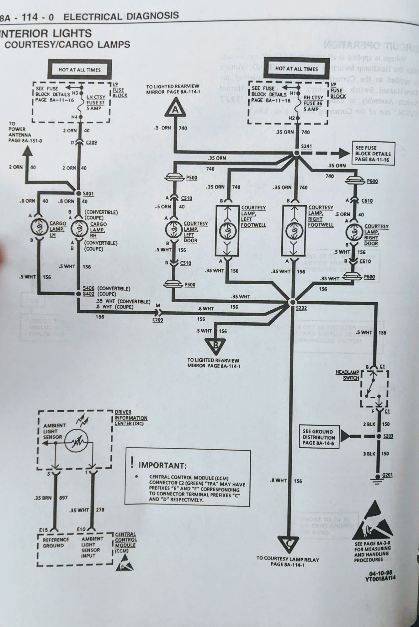

Have an interior light issue that I just can not track down. These interior lights are working ((i.e., dash, auto shifter, sun visor mirrors, rear view mirror, cargo bay (coupe) come on when open either door (note: door ajar light on instrument panel also functions with both doors) ), and the orange LED high lite lights on the door pull handles. Exceptions: the 2 door panel lights, the 2 foot well lights and the center console light do not function. Additional note: checked the bulbs. Unless there is a separate circuit for these 3 lights I am at a loss. Any suggestion will be greatly appreciated. Thanks Bob

Check the RH CTSY Fuse 36, that controls those lights...although the center console should be separate.

Thanks. It was the #36 fuse. What threw me off is that I mistakenly "assumed" the vanity lights in the visor and the rear view mirror where on the same circuit - there not. Just FYI for folks like me, the key must me in the on position for the vanity and mirror lights to work.Thanks again, Bob
