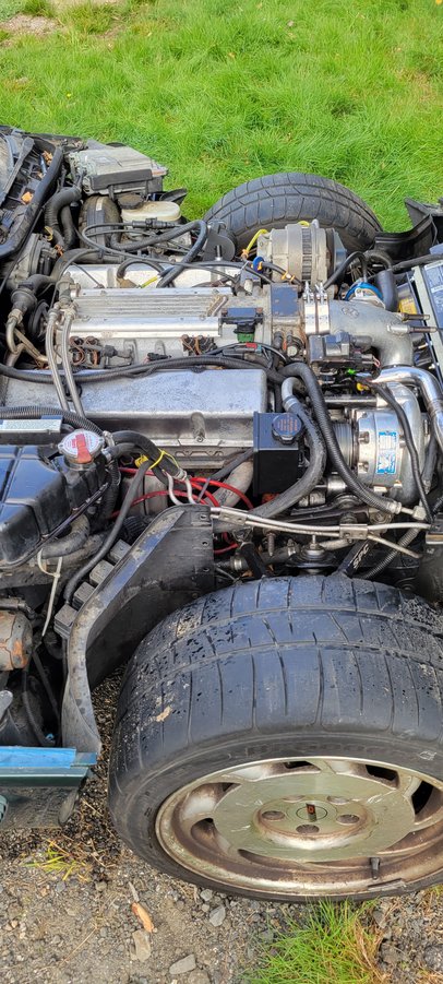

My supercharged 95 LT1 has been running rich
I get the infamous check engine light, but no codes
I want to see if the sensors are talking properly

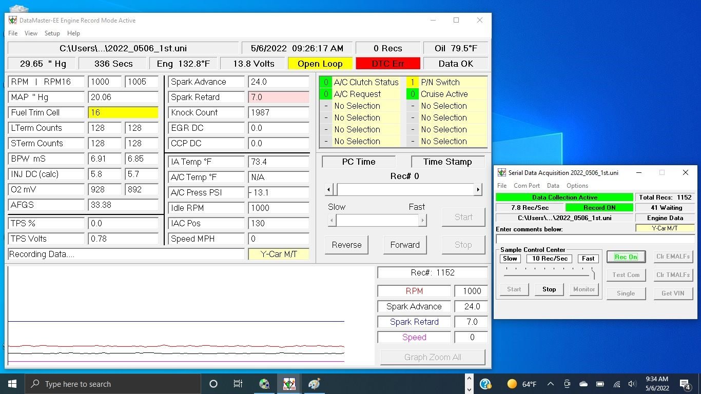

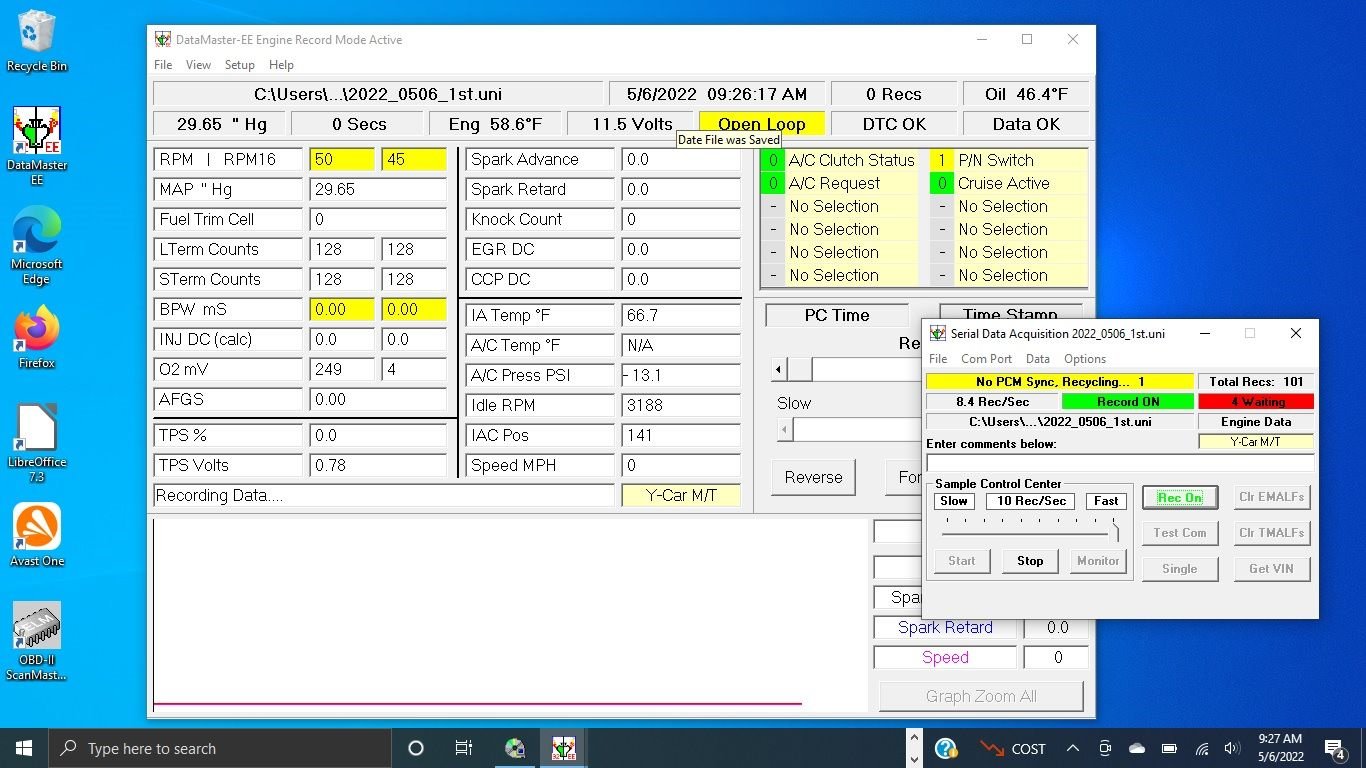

I installed Datamaster from the C.A.T.S. and it talked with my new cable
I've replaced one of the 02 sensors. the 2nd one is being a PITA to get out.
So I fired it up to see if they agree with each other.
At 1st they didn't, but they came in sync as it warmed up.

AFGS is in grams/sec
So I did a quick calculation
Density of air
1.225 kg/m^3
1225 g/m^3
Engine size
383 ci
6.28E-03 M^3
Half for a 4 stroke
191.5 ci
3.14E-03 M^3
Engine speed
925 rpm
15.417 rps
Flow
2952 ci^s
4.84E-02 M^3/s
59.26 gps
