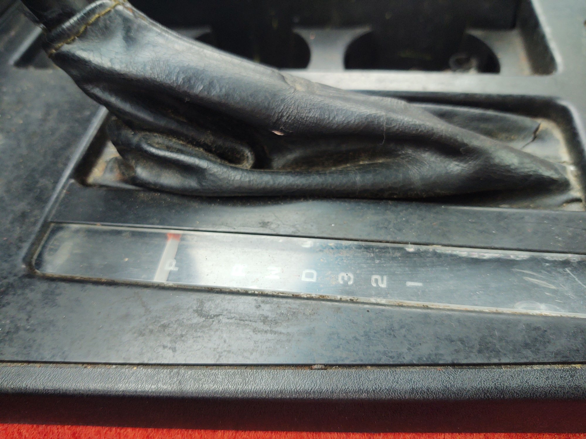

Mine is the same. April '83 production date.

Going through my tech manual, I see both PRNDL'S are listed.
