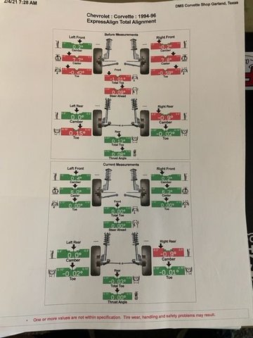

Here are the alignment numbers. It was aligned on 2/4/2021.
I bet I have put about 1500 miles on it since then. I just drive the car for fun. Errands, cruising, fun stuff and it's fun with the 6 speed!

Looks reasonable on the alignment. Right rear camber is a little off compared to the left, but that shouldn't cause the issues you're having. I'm back to thinking it might be a tire with a belt shift. Perhaps you could swap front right with front left and see if the pull goes away or changes direction. That would tell you a lot.
