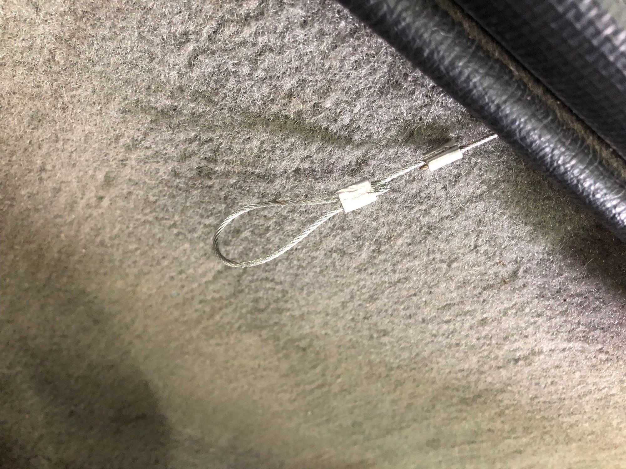

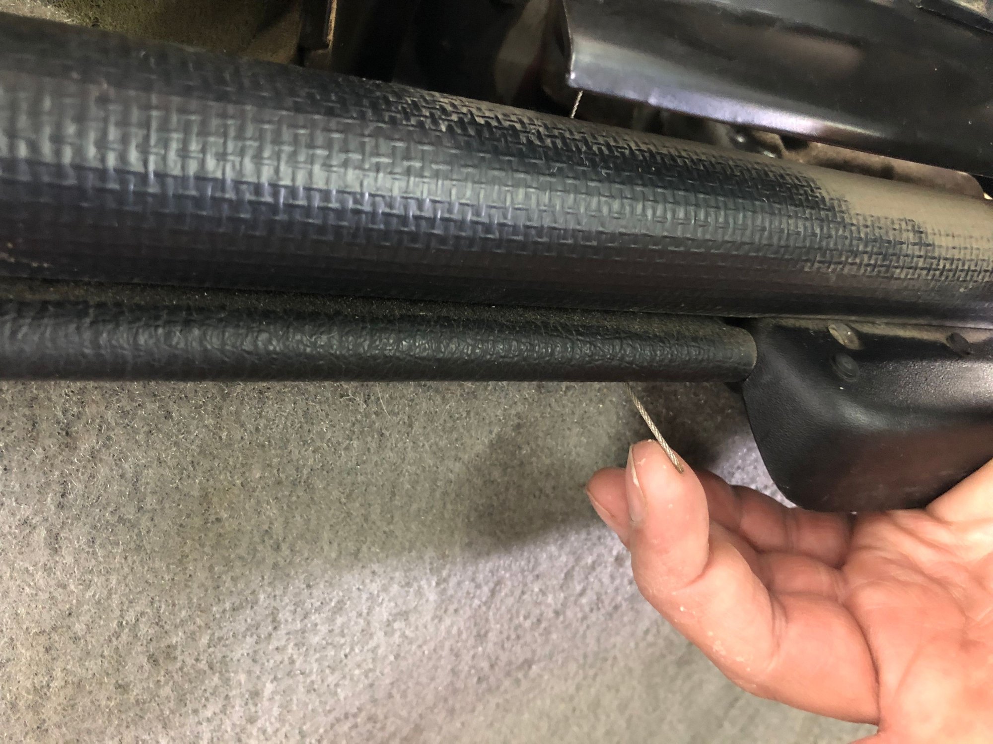

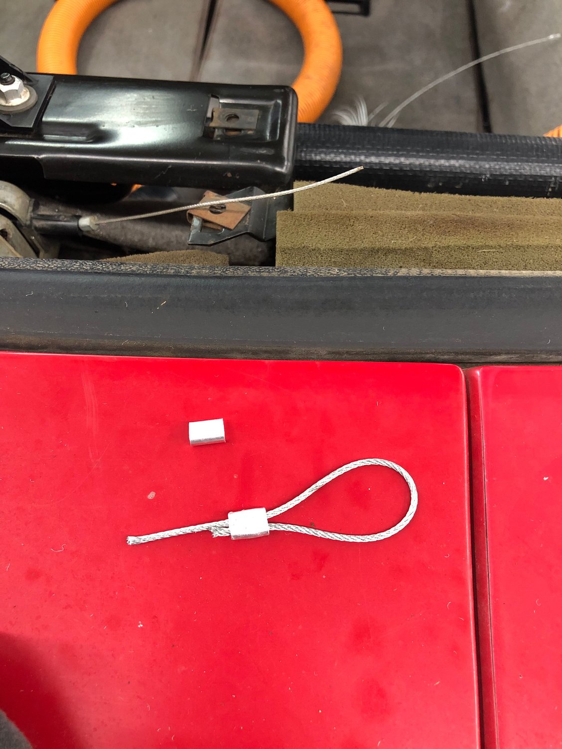

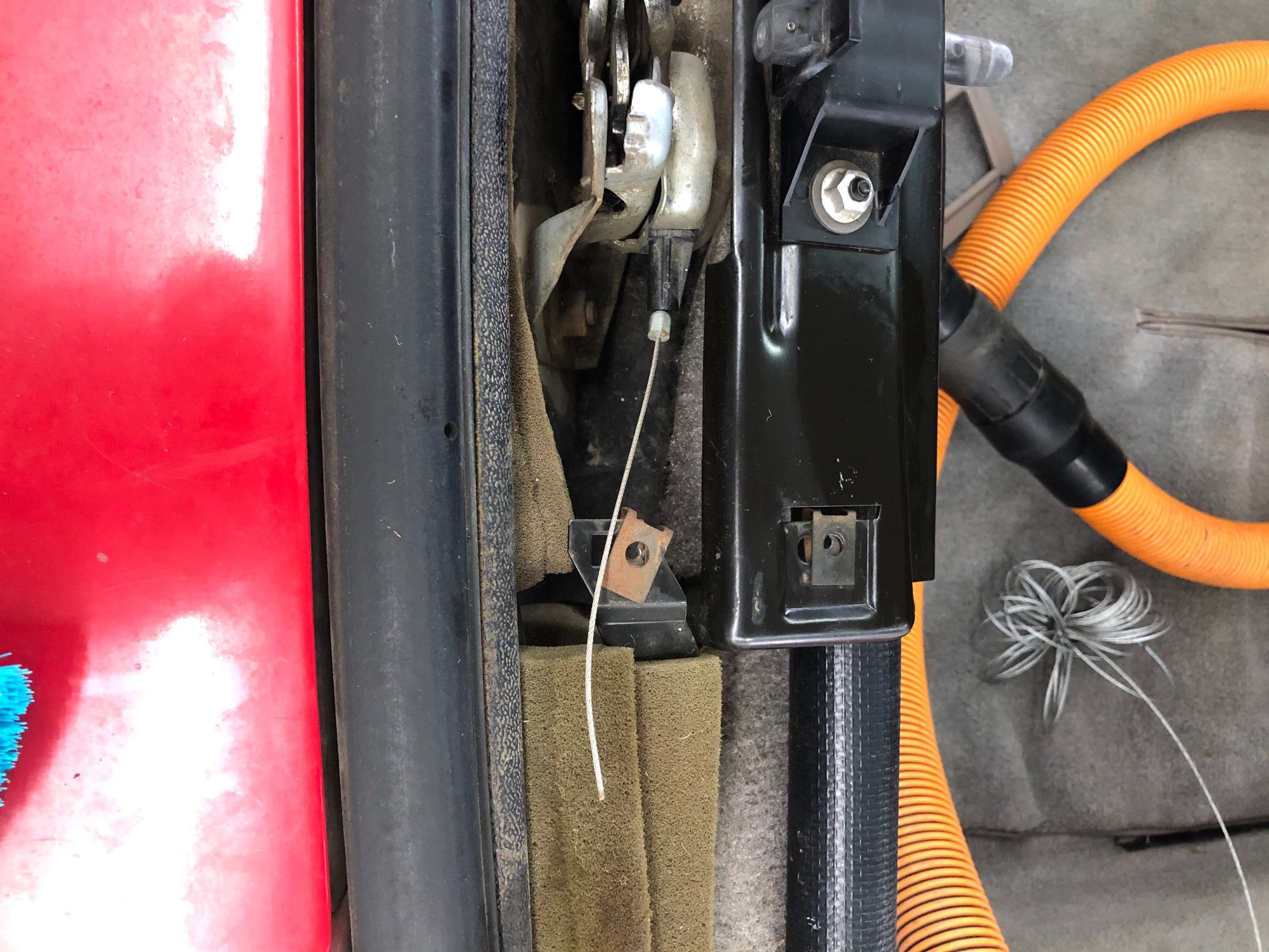

i just happen to have these pics for you.
as dogs said, there is a little tail, get in there and reach under there to find it.
u r looking for that little tail. reach under the shade roll.
included as suggestion

Originally Posted by ihatebarkingdogs
I like it.
Put some heat shrink over the swedges so you don't stick your finger with the bare wire strands feeling for it.
I’ve got to do that. Great idea.
