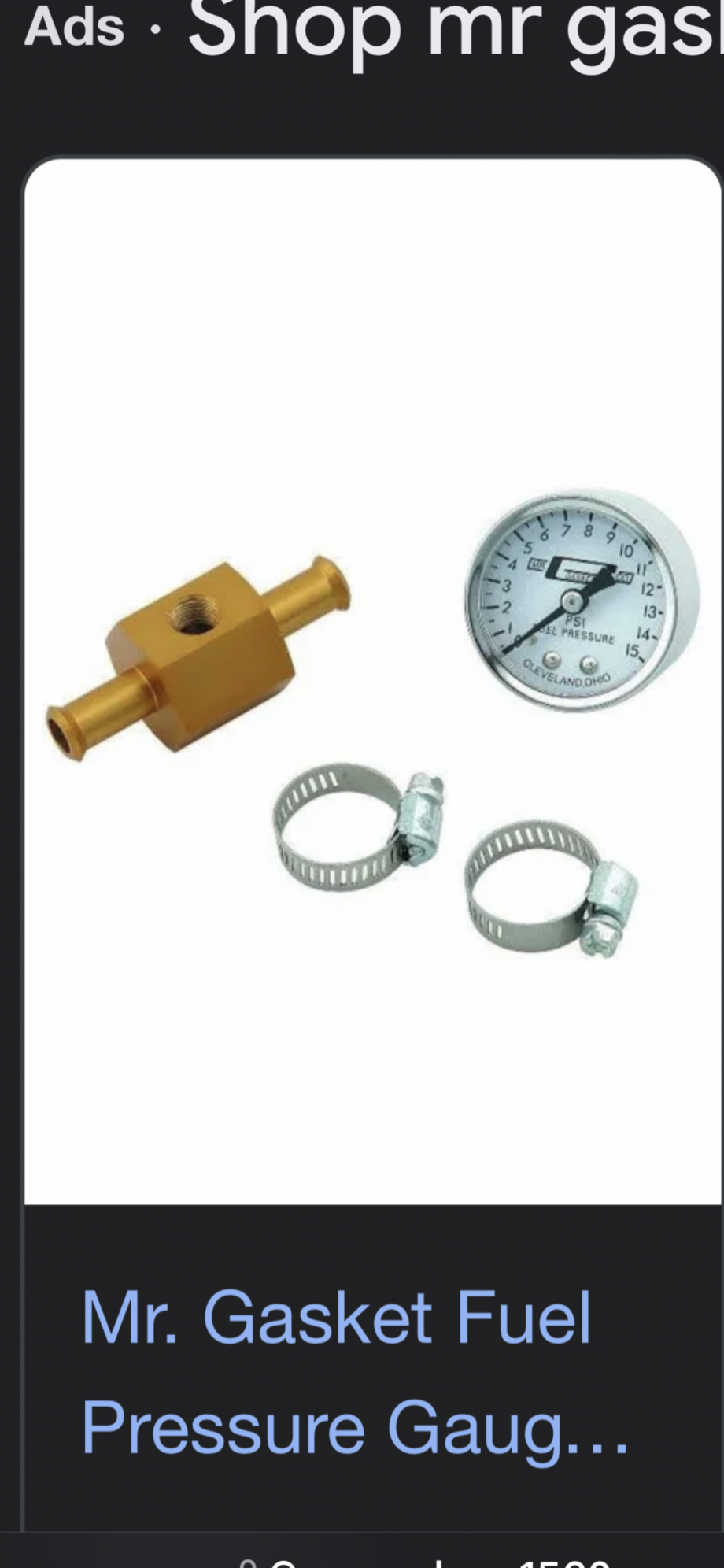

Timing is set at 6 I have played with 8-9-10 and she LOVED IT, at 11 she got a slight ping so dropped one degree and she was awoke lol. Since having a issue I put it back to 6 degrees for time being. Yes I can jump under hood safely and watch but what am I looking for exactly. I know when I am under hood and the gas gets hit it’s gonna die out lol so what do I watch for sense right now I have NO CLUE or what’s going on? I just bought a fuel pressure gauge (a mr gasket 1560)
ima splice in tomorrow.

So at idle it runs at 10PSI as soon as give any gas or revs it drops to 6-7 is this a issue? I have some videos ima try and upload of it all. Since can’t upload the 5 second videos I will add my YouTube link to my channel after I upload the videos.
Yep. Should stay rock solid at 10 (or what ever it's set at) under all conditions.
EDIT: needle shouldn't be shaking during idle, either. But that drop when you throttle it; no good.
