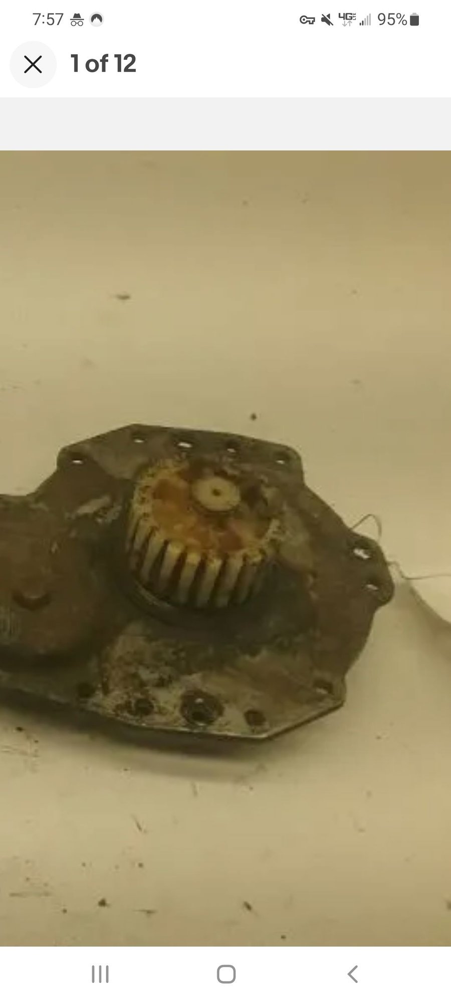

All of the motors for sale for my car have a 9 or 12 tooth gear. My factory one is 22. Anyone run into this issue?
So are you saying that you have ordered the correct motor for the 84-85's (GM 22039707) and the tooth count is off?

Default Teeth
I would like to order a motor but they all have less teeth. That could be a big problem.

Could it be that a previous owner before you stuck an incorrect motor in there, and it just happened to work for some period of time? I ask that because the ribbons for 1984-86 all have the same tooth count. This is proven by the fact that they all take the same ribbon, and the tooth count doesn't vary.
If I were in your shoes, I would order the correct motor (mentioned above) and a new replacement ribbon. You will remove any doubt everything is correct.

Default 85
Bought car from orig owner, dont believe they have been changed and i found another one like it on ebay. Gear is nylon, 22 teeth.

Default Ebay
Another on ebay. 224853422706.
iam thinking it was a one or two year item
