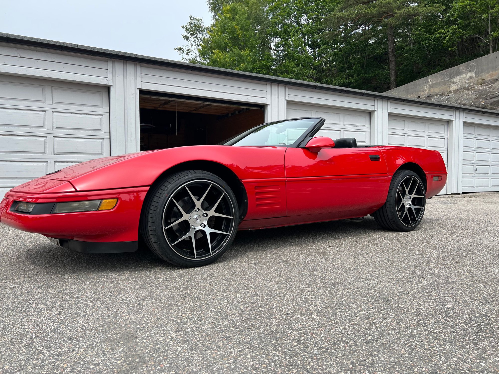

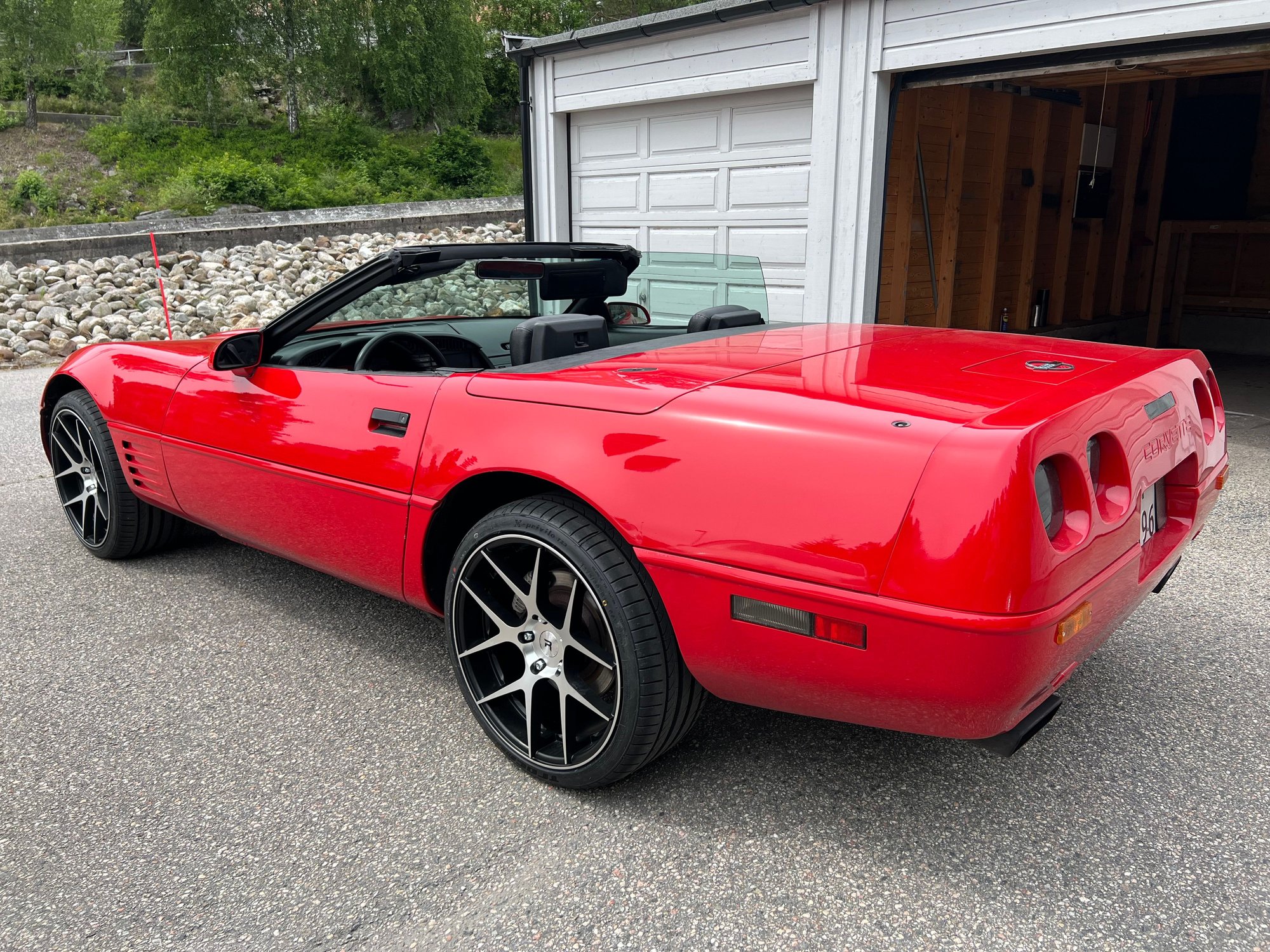

at least got to put new wheels on the car today
275/30/19 all round. With 5x120 rims offset 45. Fits like a glove. Rides beautifully
