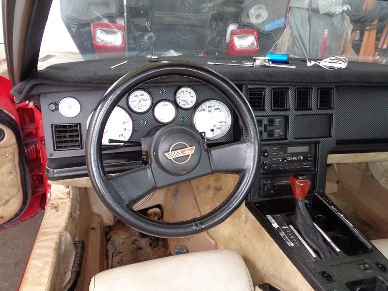

I know it's subjective but I never like the look of the Digital dash from day one.
I'm just going to put this cluster in it for now, just so I can get an Inspection sticker and actually drive the car.
I know it's not the best looking unit but I miss driving this Vette, it's been almost 4 years of frustration.

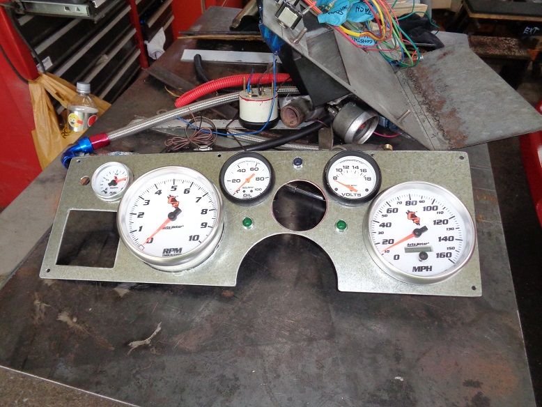

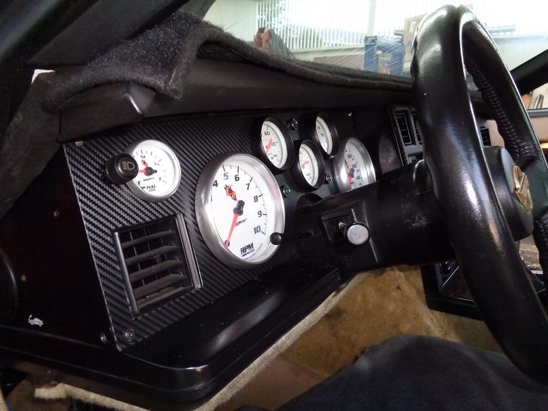

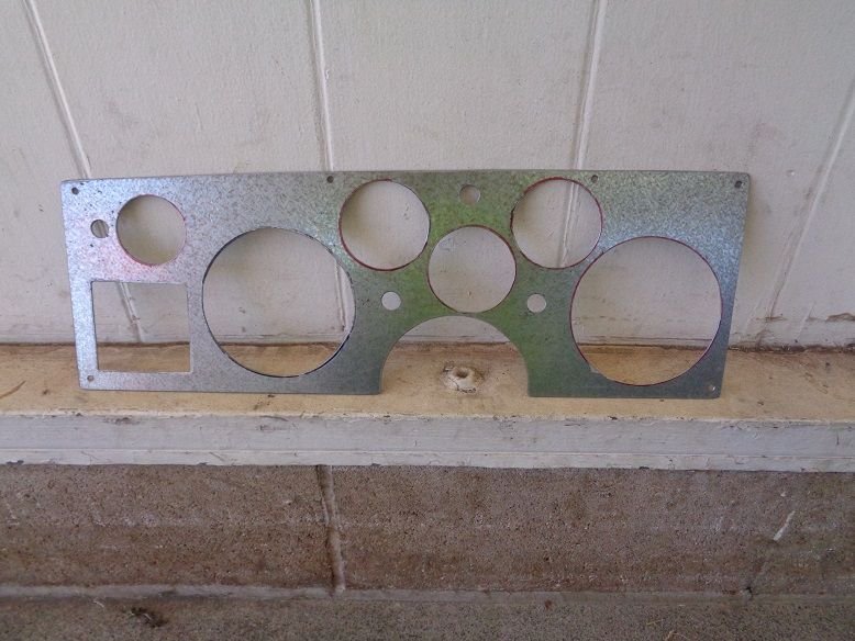

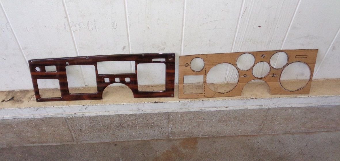

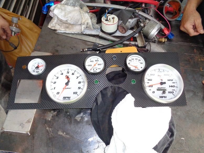

Can't remember where I downloaded these from but would give you some ideas for a diy install...

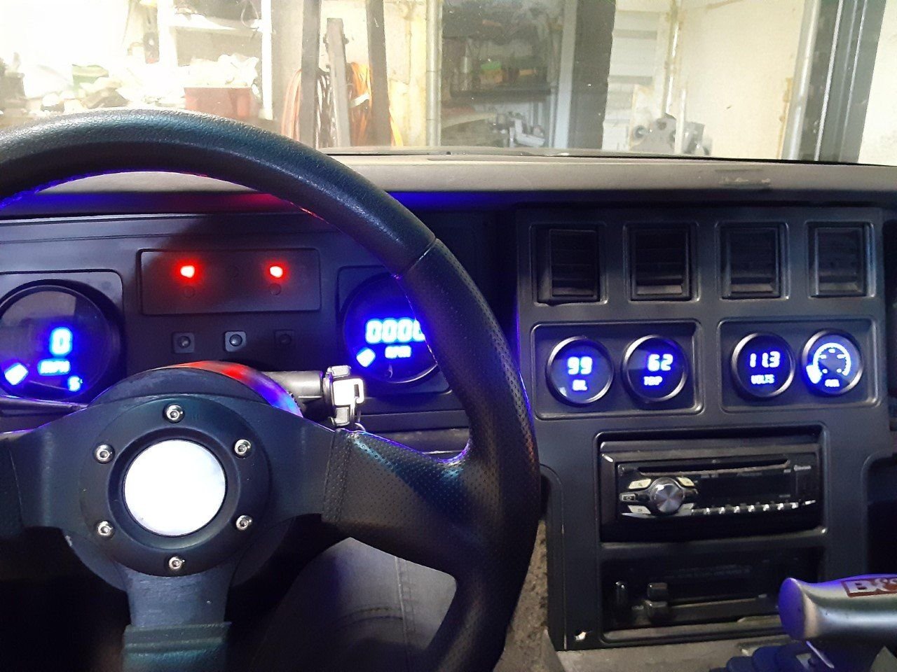

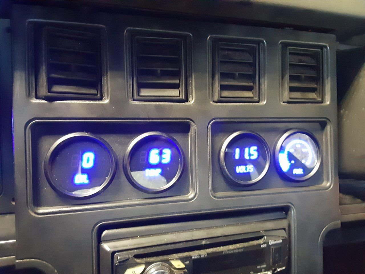

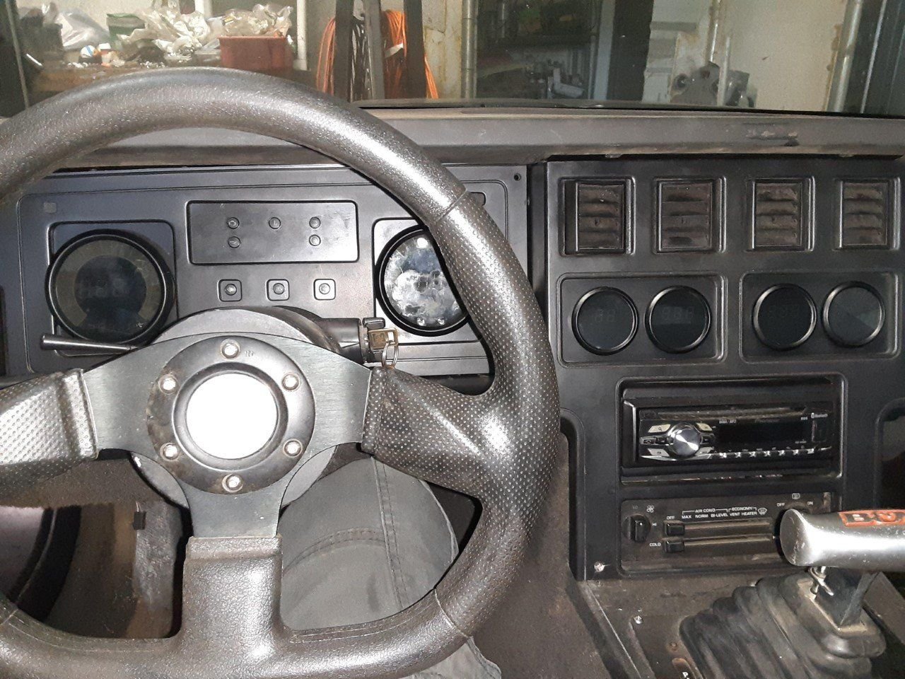

This is mine. Sorry the pictures are so fuzzy. My phone camera was fogged up.
I used sheet metal to make steel back plates. I used construction adhesive to bond them to the factory bezel. The gauges are all Intelitronix. The idiot lights (turn, high beam, low oil, over temp, battery, SES and brake) are all cheap LED's from ebay. The oil light is run by an Arduino in the dash that is fed a signal from an oil pan float switch. The battery light is wired off of a relay under the hood in series with the alternator winding. Over temp and SES are powered by the Holley ECU. If AFR or knock counts gets too high it blinks. The brake light is wired to the e-brake.
I couldn't get rid of the factory cluster fast enough.

Originally Posted by Mr. Magoo
Thanks guys!
ow
That is SO much better looking than the stock cluster. I despise the cluster in my '84.
I'd welcome more detail on that cluster if available.
