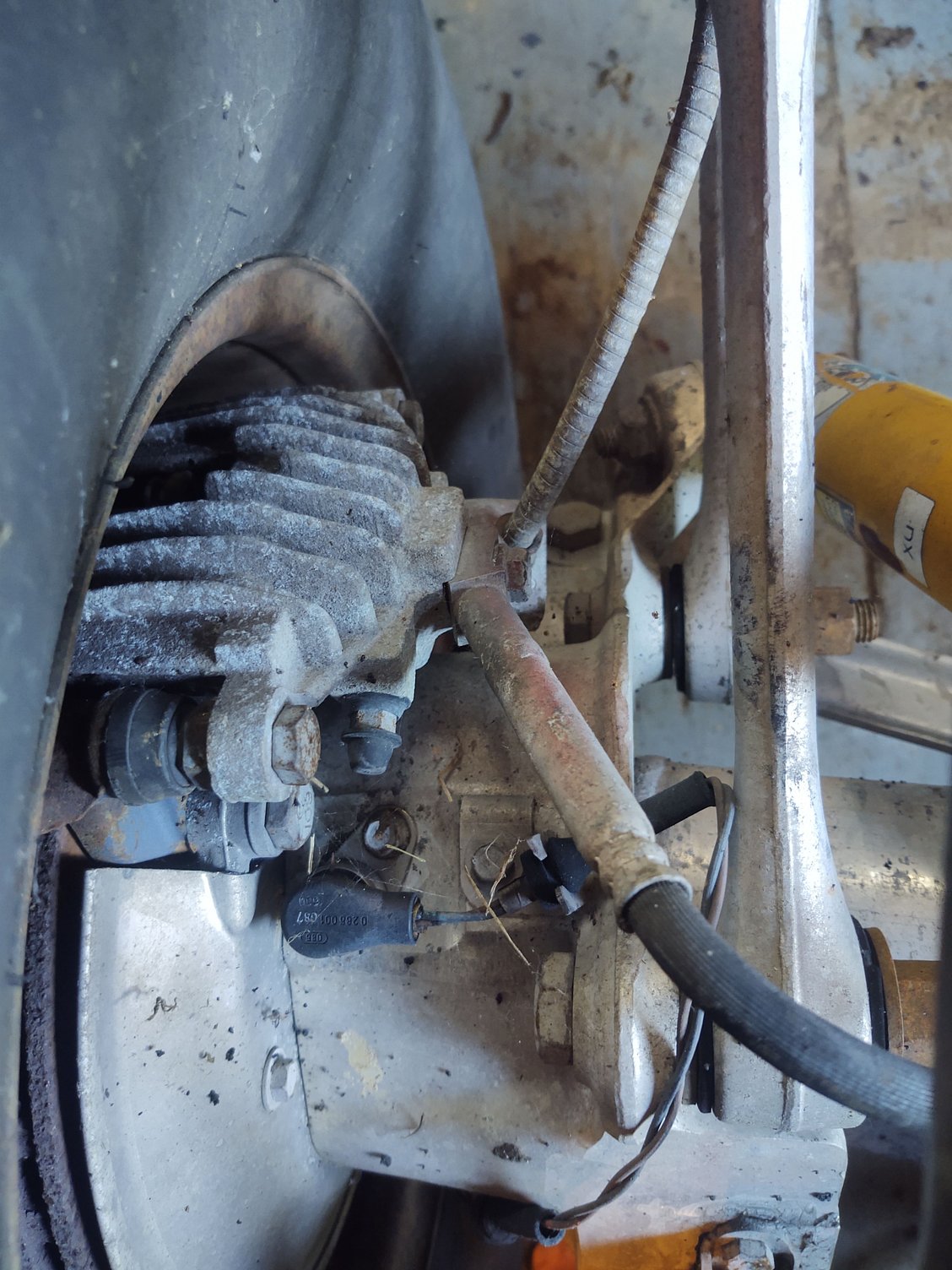

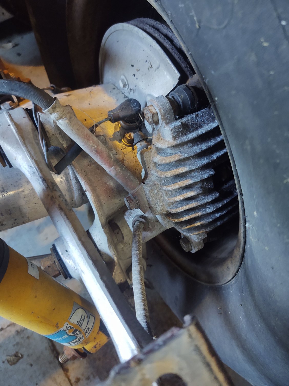

Hello all!!
I have a C4 rear suspension and front clip that I will be having fabricated into my hotrod build. I have been trying to verify the production year of my parts. I did find a part number on the front steering knuckle14093184. Research says, it from an 86/87 Corvette. Now from what I have read I should find manufacture date and gear info on the bottom of the differential. I also read that sometimes that information is not stamped there. Well, that info is not there and that I should look at where my e-brake cable is attached. I also know it is a Dana 36 because of the bolt pattern. I am seeking information on what gear I have. The engine is a Gen III LQ4, a T56 6 speed manual transmission with about 600 HP. I am not building a track car, more of a street car. Would the stock gear ratio be good or should I upgrade to a different gear ratio and what would you recommend?? The car will not be doing any long road trips, just local car shows probably within a 50 mile range.
Thanks so much!!
ELEE

Well it's certainly early and ABS so '86 or '87. Easiest way to determine ratio would be remove cover and get gear information off of the ring gear OR maybe just do a ratio check turning axle one rotation and check pinion rotation. Should be easy on the ground. Axle ratios that you might find are limited 3.07 would be 'numerical highest', 2.73, 2.59 the other possibilities.
Most might recommend you get the ratio of the D36 you have and sell it as it sits. A 3.07 would sell easily I'd think and then just do a D44 build. Is the early suspension desirable? These days maybe not. If the build hasn't started maybe rethink it in it's entirety if the engine/trans and horsepower are the choice.
