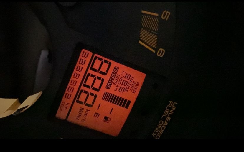

At key on the LCD back lighting comes on and all the display is lit up but this only stays for about a second.
What happens at key on

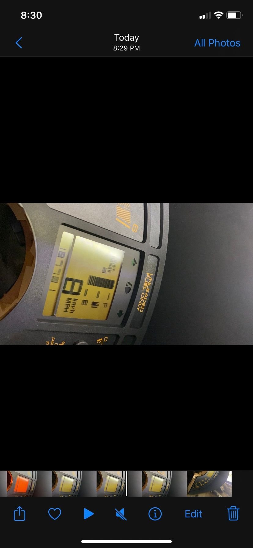

Then I would expect the normal display to come on but it all goes away and about every 15 seconds “inst range” will blink.
Then during key off, I will get a quick blip of the display like I would expect it before all the power turns off.
