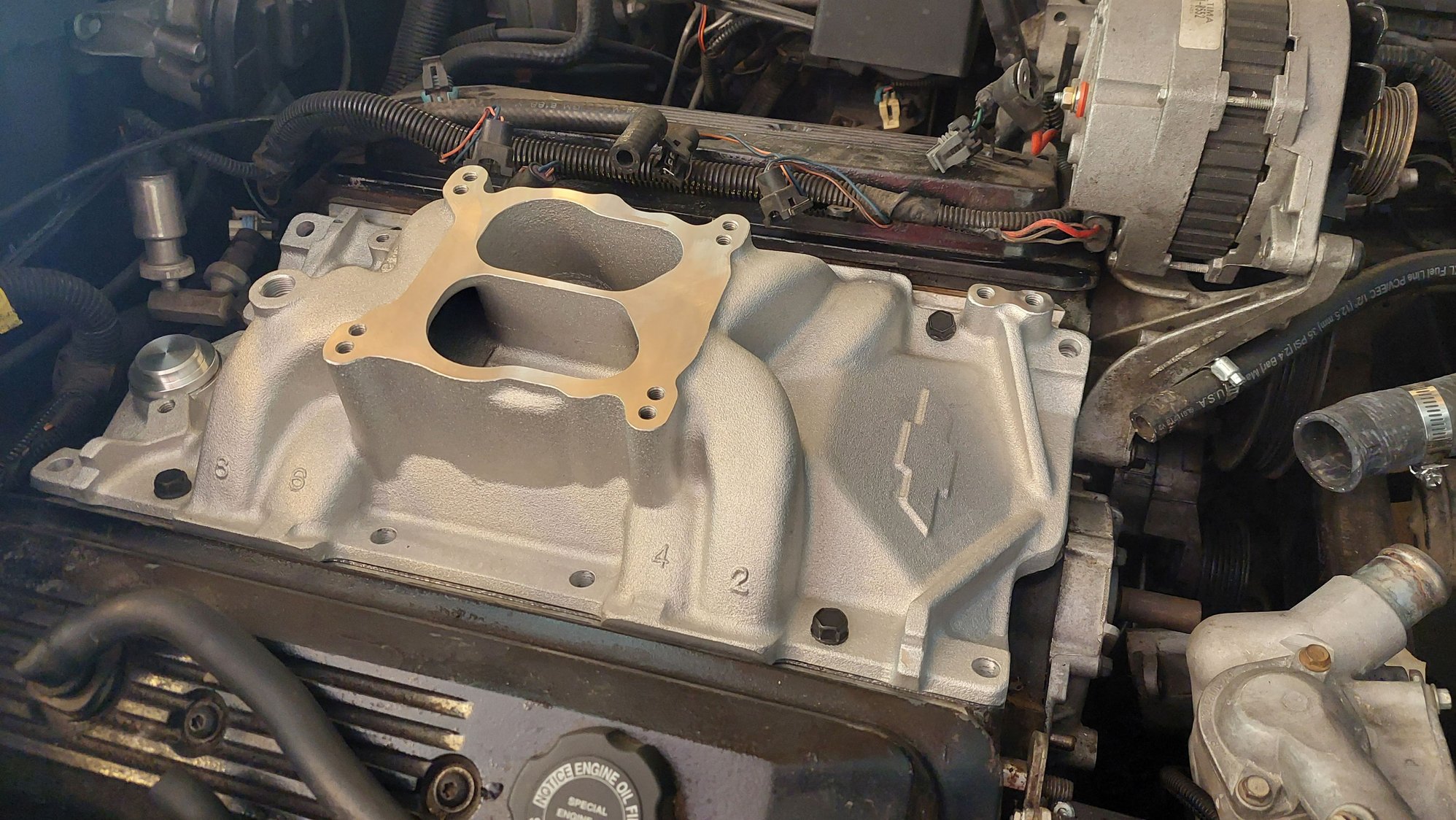

I have the GM intake and will be using an HEI unit.

You seem to have all the right answers. With HEI, I'd look more at the systems that have the control module mounted separately (hopefully inside the car). The Sniper units especially are sensitive to interference from noise, and the HEI system is a big source of RF noise sitting right behind it. I know of at least two aborted Holley Sniper attempts with HEI ignition, where the people went back to a 4 barrel carburetor after giving up on the Sniper unit.
And this is a manual transmission? The stock ECM also controls the 4L60E automatic transmission, so if you have that, you'll need an aftermarket controller for it, or a system for TBI that includes wiring and the control logic for the 4L60E.
