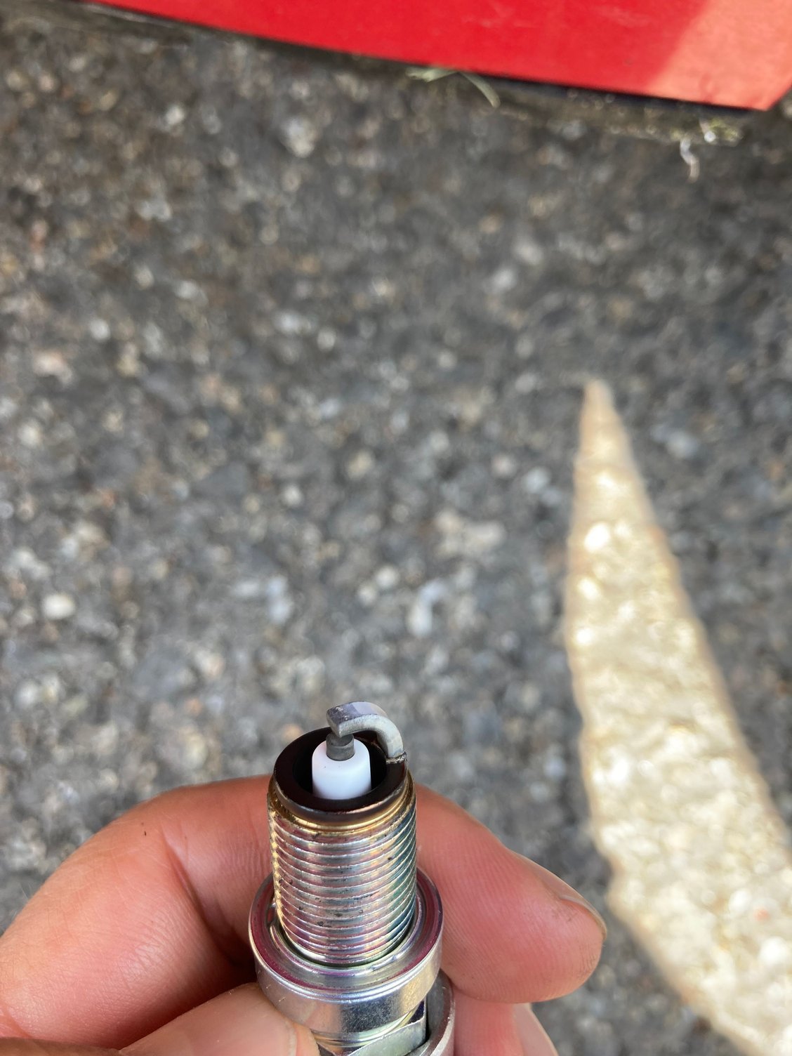

I have a pressure pulse sensor (diy) and I can check the system to see if there is any pressure leak from the combustion but I need to find a adapter. Then I’ll check the EGR to see if it opens.
Here is a picture of a spark plug, they all looked almost the same.
I think it runs slightly leaner than it should, ?!
Thank you

That plug looks a little lean. If all of the plugs look the same, I'd suspect the fuel pressure regulator, fuel pump or an injector in that order.

Now, with the lean plugs. You had better pay attention with that (has it been tuned?) because you could lean out a cylinder pretty quick and lose an engine. If not tuned, it could be a sensor is reporting a rich A/F ratio and it's leaning it out a bit. Might be challenging with OBD1

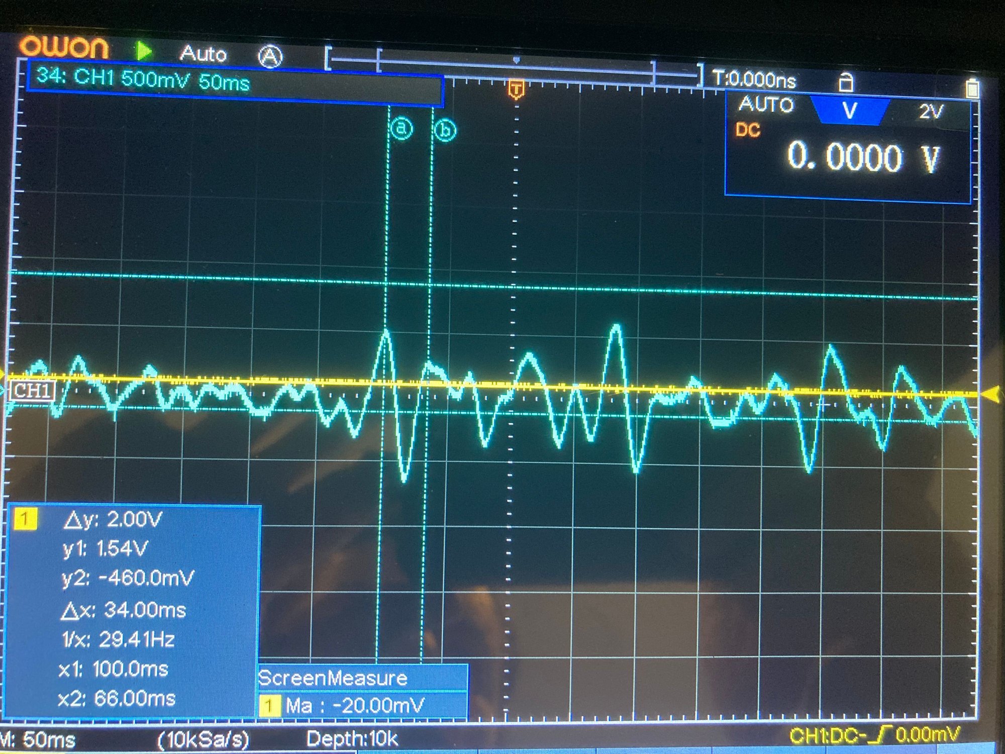

I did some tests this morning but I didn’t have the camera with me, so I checked the cooling system with a pulse sensor. There were a few air bubbles for a minute after I pulled off the reservoir cap then nothing.
These pulses have a frequency of 2000rpm at 750rmp engine speed. Firing would occur 4*750 per minute, that’s 3000/s. one cylinder fires at 375/s. Not sure what’s the source of these pulses

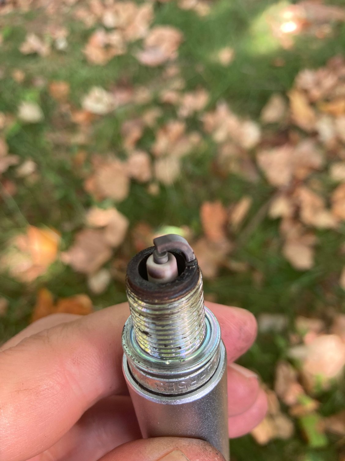

here is a spark plug after doing 21 track laps and ~100miles highway/city
looks good I think but not sure how relevant it is

That looks lean to me. If you're running that lean under load, the engine temperature will increase significantly and probably overwhelm the cooling system.
