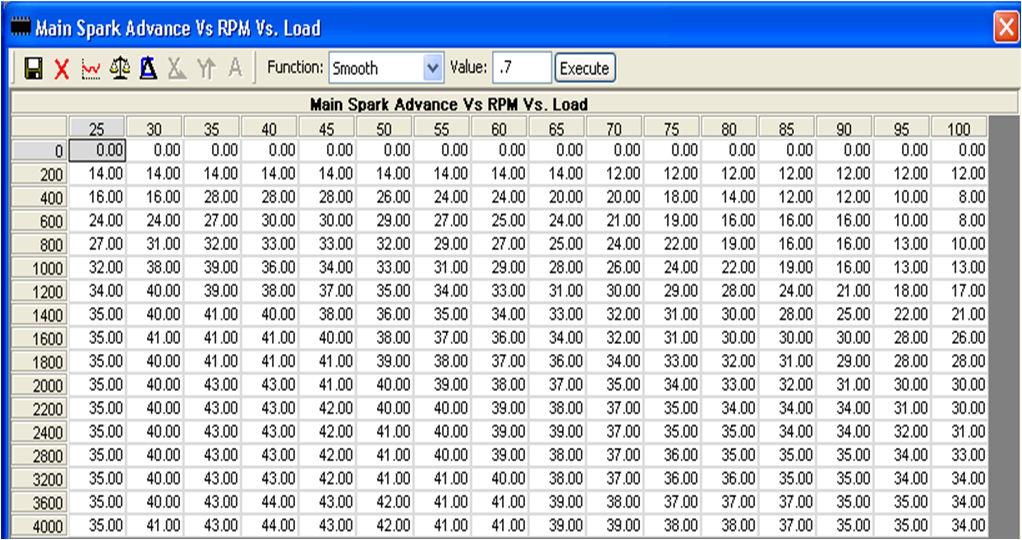

24 does seem a little excessive but if that's what GM intended it to be, than it should run as advertised without issue. With that said, were all the issues at first delivery or after items i.e. bosch III injectors were changed??? I'm wondering if the replacement injectors are delivering the exact precise amount of fuel. I understand that the ECM can compensate for fuel trims but let's just say your BLMs are all in the 135-140 range does this 5-10% lack of fuel compensated by the ECM carry over into AE TPS AE MAP which is akin to an accelerator pump/pump shot on a carb. When installing bigger injectors (more fuel), I've reduced those parameters by proportionate gain and with a bigger throttle body (more air), increased based on prop gain. Too many what we don't know and what I'm saying is returning everything back to what GM intended it to be, it should run like top. If you think it's a fuel delivery issue, I wonder what happens (KR) if you repeat the datalog with the vacuum line of the fpr disconnected??? If the KR diminishes, maybe time to crank the fuel pressure up??? Care to post up your datalog??? Idk what bcc you're running but attached is the spark map from an '92 LT1 auto...
