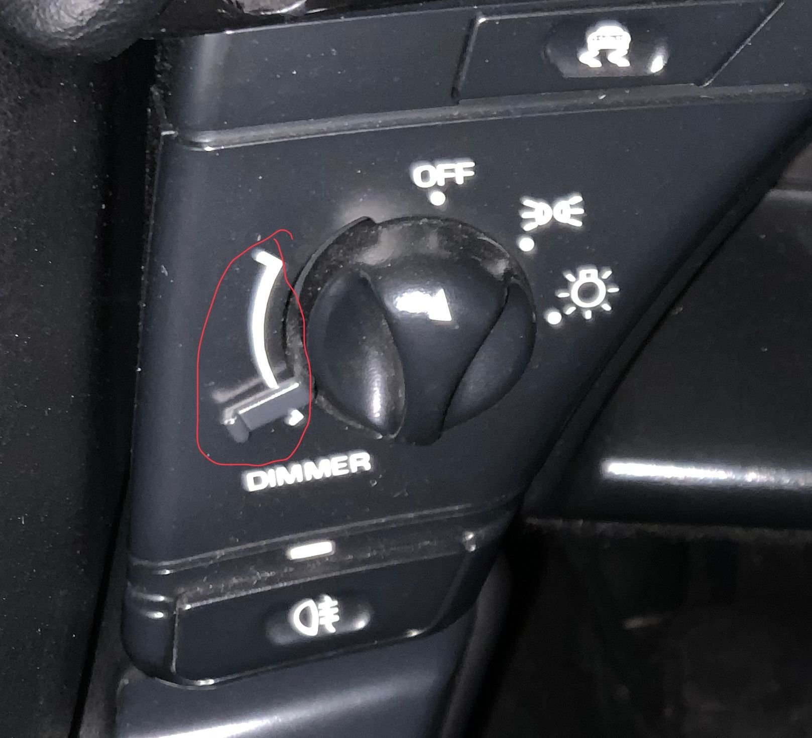

s carter may be mentioning the little lever circled in red. But I’m sure you know this already.
Old Jul 27, 2022 | 11:09 AM
Incorvettei's Avatar
Incorvettei
Joined: Oct 2020
Posts: 1,395
Likes: 437
From: Marlton NJ
The 85 doesn’t have that
