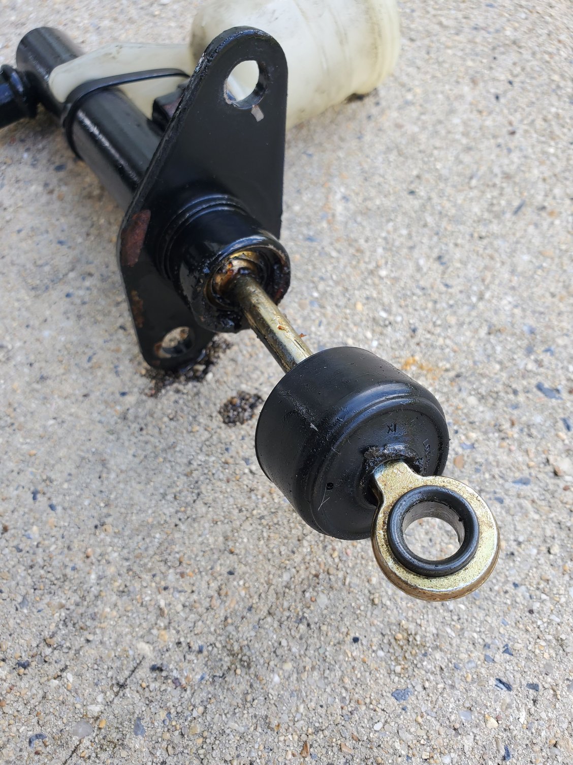

The master is not cast iron... Looks like stamped steel. Is this the original unit?
I pulled the rubber boot back from the master and a bit of fluid came out. Looks like that was it. However, I didn't notice fluid inside the firewall. Maybe I was too excited about removing the clip so quickly.

Don’t know if that is OEM or not. You could have had a very slow leak and if you hadn’t been checking regularly could run low over a long time. It’s not the most obvious thing to check since it sits under the ECM…so often overlooked.
The pedal clip, once you understand how it works you can do by feel, it’s just getting eyeballs on it for the first time!

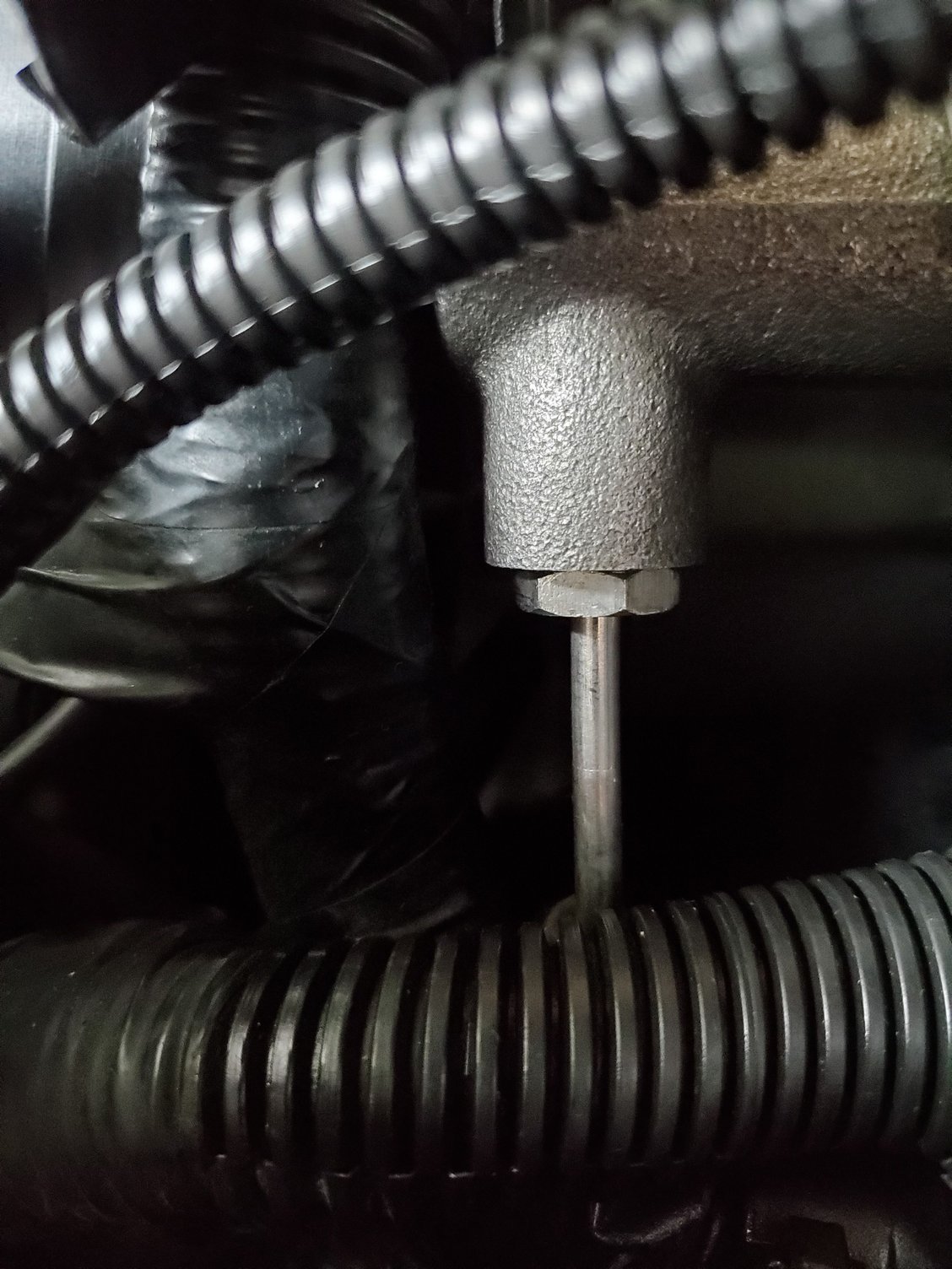

Team,
I may have an issue!
I installed the new master and hooked up the line. Unfortunately, the threads on the line maxed out against the master... See pics below. Usually the threads do not max out... See pic of brake master.
I filled up and pumped about 40 times. The pedal is hard... Haven't driven yet though, pending your help.
Am I ok or is this line going to leak?
Clutch master
Brake master

I think you will be fine… if it’s not leaking now you are probably all set.
When you say “hard” you mean firm and you are getting full travel out of the pedal, correct?

Yes... Hard as in normal operation and full travel.

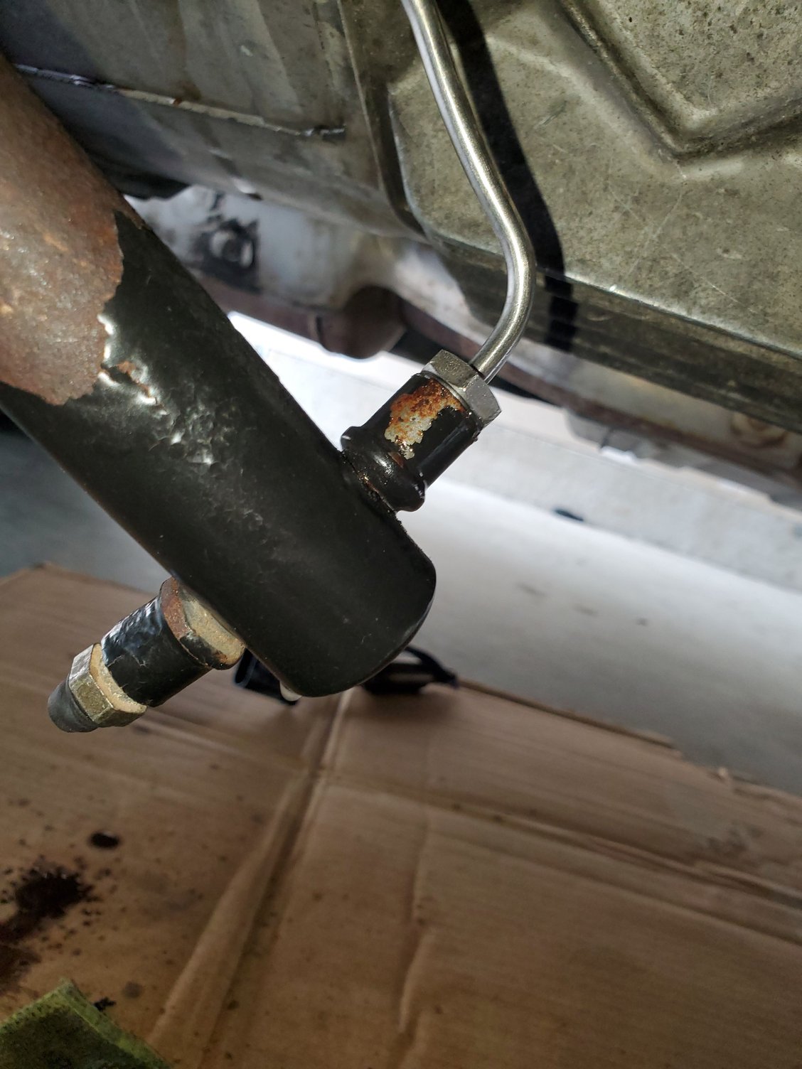

Team,
Yet another issue. 😡
I have no idea what animal tightened the line to the slave cylinder...I can't get it off. I sprayed it with penetrant and put a lot of muscle into it, but it won't budge.
Any suggestions?

I was able to break mine free without major issue so did not have this problem.
However, if I was in your situation I would probably drain the system fully from the bleeder, then hit it with PB blaster and let it soak. I’d put a small pipe wrench or maybe some big vice grips on the slave and have at it with a high quality flare wrench. Sometimes the shock of banging on the wrench with your hand can break it loose. Also, try tightening it slightly the loosening again (work it back and forth).
If that didn’t work (and partial reason for draining) I might extremely carefully apply heat, and have something available to put out anything that might lite (brake fluid can burn if hot enough but not volatile like gasoline). Maybe a heat gun would work instead of a torch.
After that, I’d just replace the line…when I did mine I replaced it. The later lines are also easier to do and route than the earlier ones. You can convert.
EDIT: Just had a duh moment, reattach the slave such that you can reach the nut and break it loose installed (assuming you can get a wrench on it).

Thanks for the advice. I was able to break it loose shortly after my post. I think the penetrant helped a bit.
the threads fought me all the way out, as if cross threaded. The problem was rust outside the shave cylinder threads.
Anyway, I cleaned the threads on the line with penetrant, wiped clean and reinstalled.
By the way, a regular wrench is too long with the slave back on. Maybe a stubby wrench. Hell, I even removed the O2 sensor to make life a bit easier.
