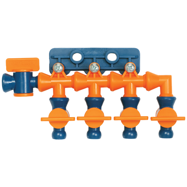

I wonder if anyone has built a manual ac control package for these cars or adapted a control package from another car to work. Seems to me all you would need is a five valve manifold something like this only with better panel mount valves
and then get a potentiometer to supply a variable voltage to the blower control module to regulate fan speed and a toggle switch for the AC compressor. The probrammer and the control head could be removed and the cars ac would work manually. It would not be a streatch to incorporate a digital thermometer to control the AC compressor with a pretty good dead band so the compressor does not cycle and also to control the fan automatically I think the out put needs to be like 2 to 7 volts to the blower control module (fan resistor some call it). These parts for our C4s are not made anymore and are not very reliable.
