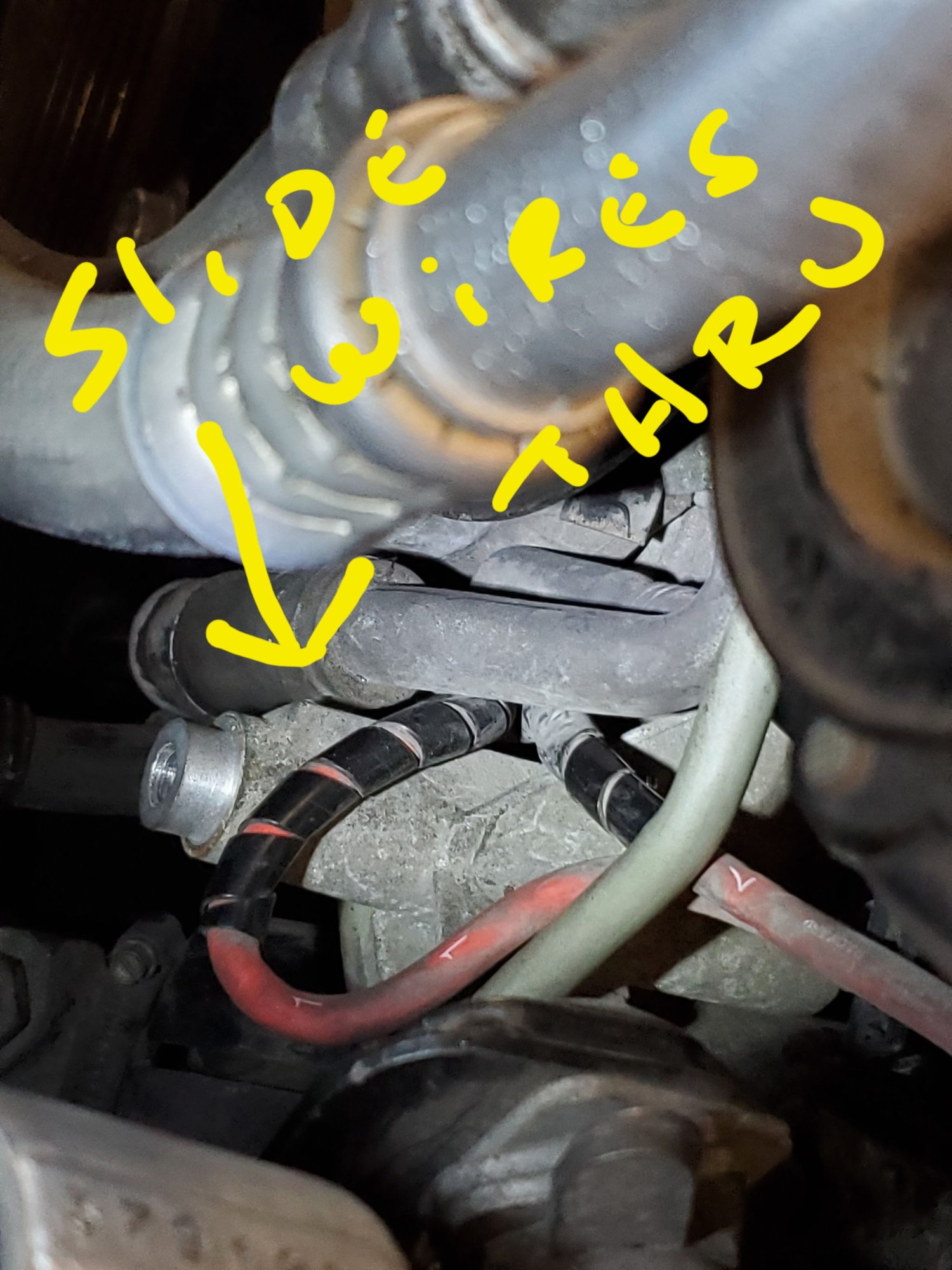

Team,
I finally got the courage to swap out my original red wires for AC Delco replacements (black wires).
Passenger side is a 4 in a 1 to 10 scale, 10 being an absolute nightmare.
The driver side was a 10 on steroids, at least untill I figured some things out.
Here are a couple of tips for would-be DIYers:

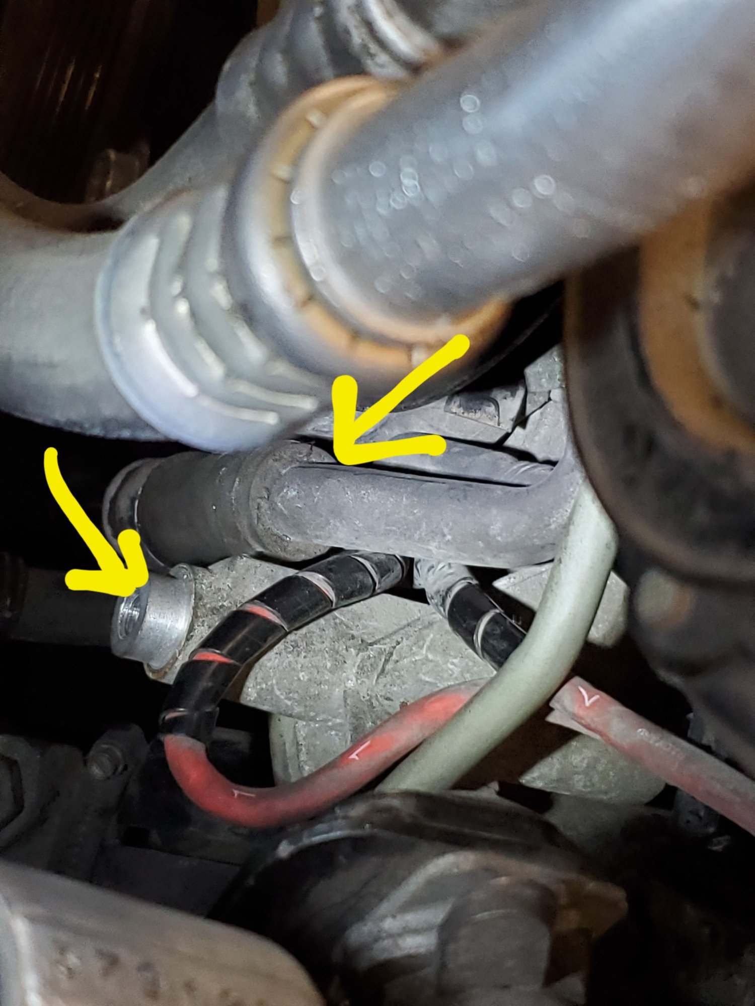

- Remove intake ducting from throttle body to the filter box. You'll need the room- Remove idler pulley... You will need the room AND you'll be able to duplicate how the wires were routed from the factory a bit easier- Remove tensioner pulley for clearance- Unplug ALL the wires on both ends, pull them all out at once. You will need the space and clearance. Doing one wire at a time is just painful. See picture below and look how tight it is between the brackets
The biggest hurdles:
- The way the wires routed in between brackets, behind the power steering line and idler pulley (see picture, left side arrow)
- The clamp holding the power steering hose to the metal line (right side arrow). One of the squeeze tabs was pointed towards the idler pulley. This added extra " snaking" through of the wires for removal and installation- After 26 years, some of the wires were vulcanized to the Opti terminals, it seems. Removing and installing the top one on the driver side (#5) had me cussing up a storm. Very odd angle and tight clearances to get to it
Of course, it doesn't help having an air show taking place 3000 feet over your head.
Anyway, since I was already this deep, I went ahead and ordered a new tensioner, idler pulley, belt... And new wiper blades.
