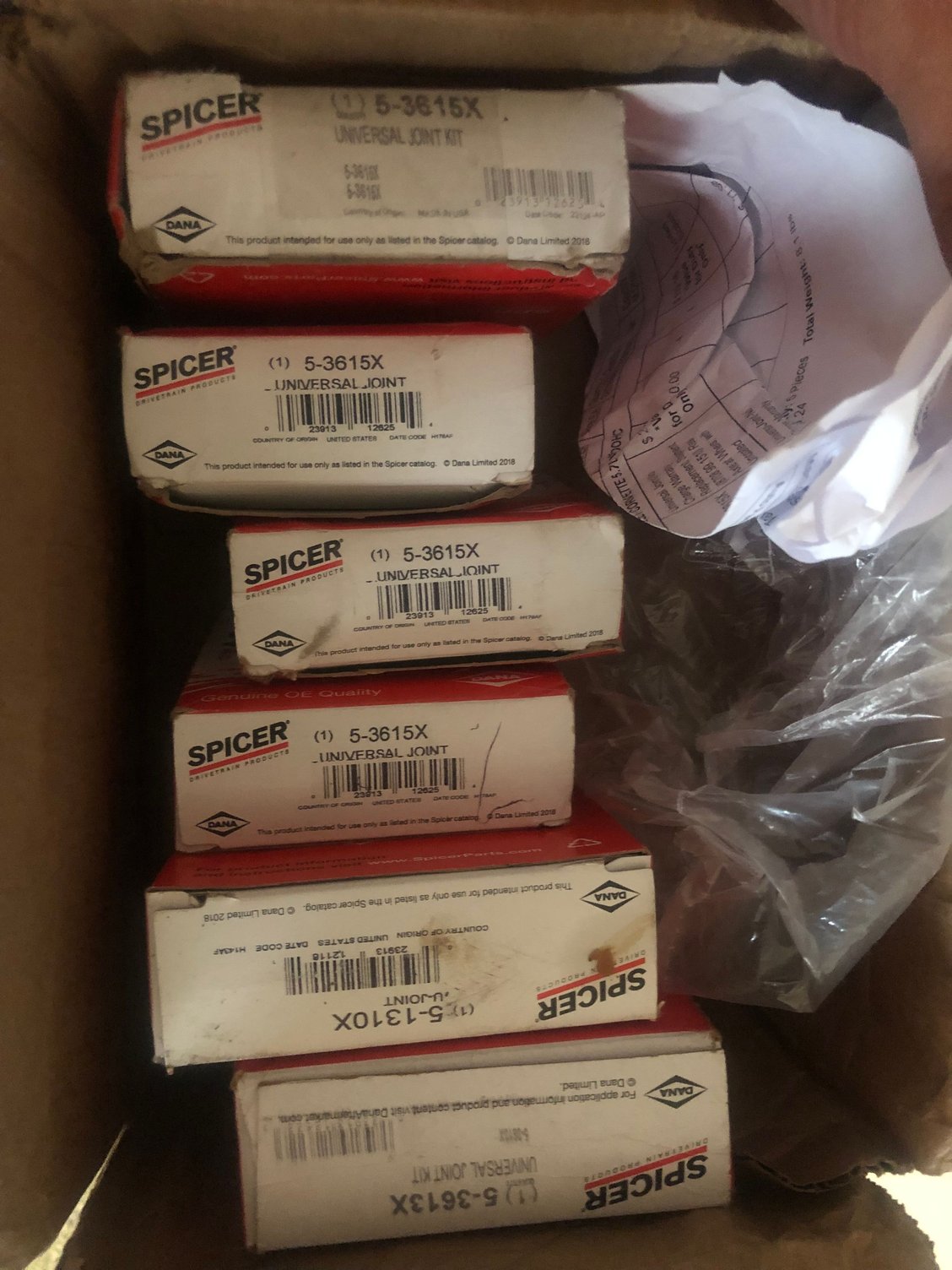

Hi Guys,
I am looking to replace all of the universal joints in our C4 and am a little confused with part no's etc. Wanting to use Spicer parts.
I have looked on Denny's Drivelines and it appears that the parts I need are:
Half shafts: 5-3615X (coated, non- greasable)
Drive shaft: 5-3613X
Is this correct?
The problem I have is that.I am in Australia and most US stores won't ship to us, including Denny's
I can get these parts from Rock Auto, however, their website states that the 5-3615 for the half shafts is "uncoated". I would have thought that being the same part no. they would be the same part??
if anyone can shed some light or offer some advise, it would be appreciated.

Because the Drive Shafts are Aluminum your suposed to run the coated U-Joints. That being said I don't think to many have had any issues using the regular ones. I'm in the process of replacing mine and Rock Auto just sent me all the Wrong ones for the 1/2 Shafts. I just ordered new ones from Amazon. The 1/2 shafts should be 1350's and the Drive Line 1310.

pontiworld (USGM parts) have the U joints for C4 if you dont mind paying extra - but the shipping is quick and you generally get the correct stuff.
USGMSP.com (pontiworld.com.au)
Rockauto are usually pretty good too, 7 days and delivered at your door. Cant beat their prices.
Dont worry about the uncoated, if your worried rub a slight smear of grease over body with finger or a quick spray paint. but if its the same number its usually the same part.

the other option being in Australia is to just go to the local bearing place, and take the old ones with you.
1310 and 1350 u joints are quite commonly available in Australia.
There is a SKF bearing place near me, and you can take just about anything there (including just the part number) and they will get it, and usually quite cheap.
I bought bearings and seals for my Dana 44 there, and also got a complete set of wheel bearings for a Kawasaki 900 just recently for about 1/3 cost of the sets from motorcycle sellers.

Absolutely nothing wrong with SKF's. I have SKF's to go in the halfshafts. However, I had originally bought SKF's for the driveshaft but changed my mind due to the zerk fittings and the caps didn't look to be coated, even though they were suppposed to be. The halfshaft ones look pretty good.
