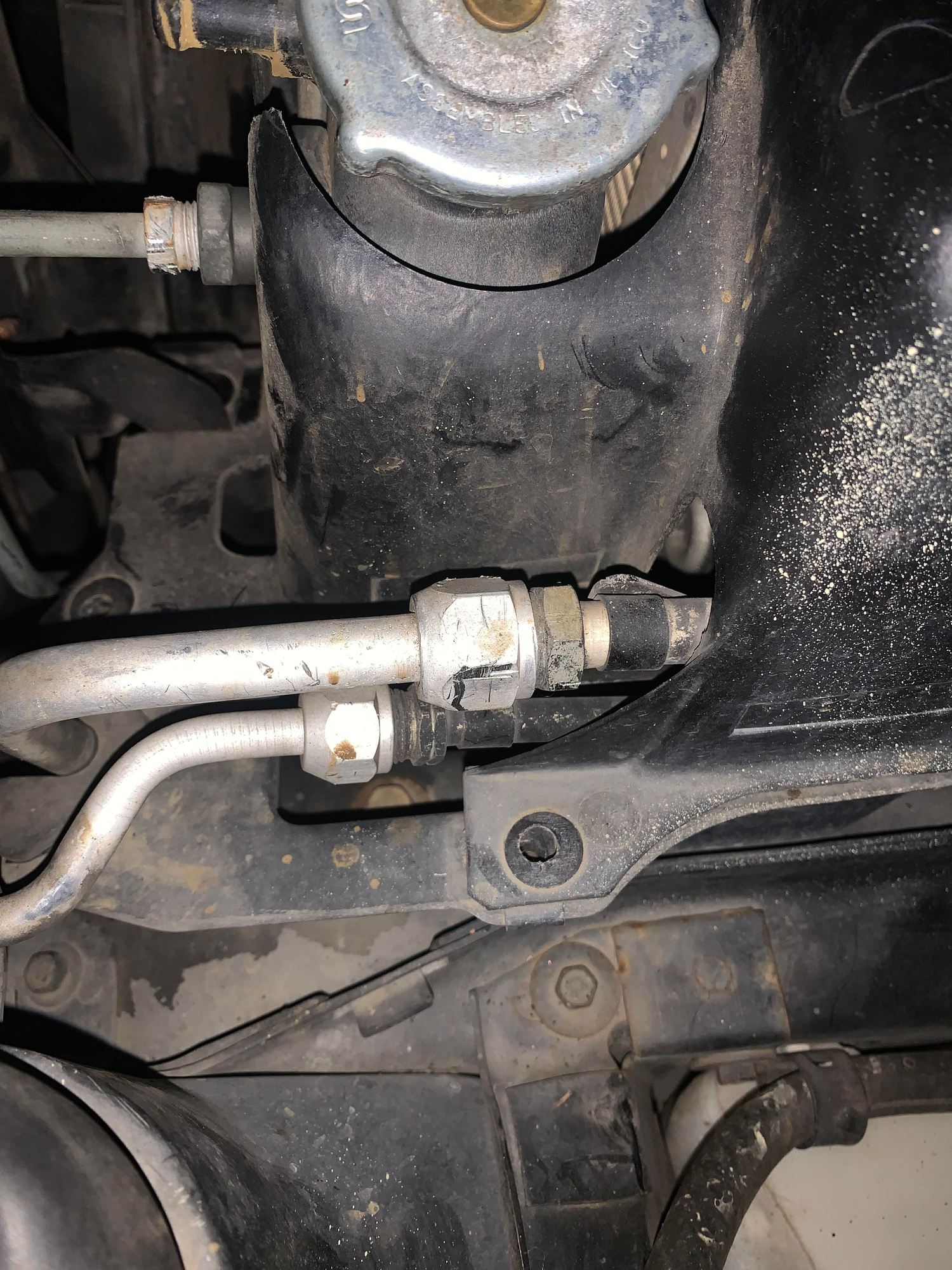

Good day! I am looking at replacing the radiator and condenser. I was having some issues on how to take off the lines. Will this tool do the trick?
Segomo Tools Fuel Line Disconnect Tool - 5/16 Inch & 3/8 Inch Fuel Filter Tool for Quick Disconnection - Fuel Line Disconnect Tools for Fuel, A/C Line Service, Heaters - FUEL01

Those fuel line disconnect tools are not correct for the trans cooler lines. You want a "flare nut wrench" Dan
