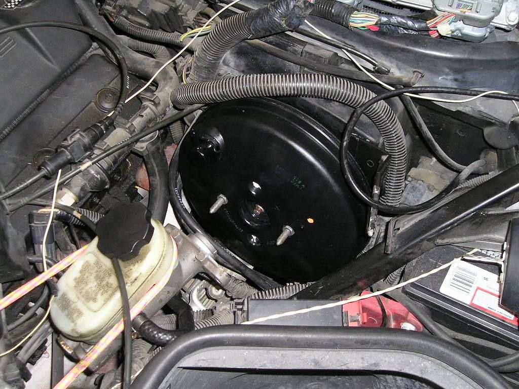

Go with the braided lines I have them on my 94. They are advertised to make the pedal more firm and take some sponginess out, whatever. I was chasing a problem years back and replaced the lines. Didn't fix it, but glad I replaced them anyway. I don't think its ABS either. The earlier 80s cars did have ABS problems clogging with no fluid flow but I think your good on this. And I never used any special tools to make a slight adjustment.
So here is a poor picture, all I got presently in my pictures.
You hold the rear larger shaft and turn the inner screw (nut) to adjust, If you wind up going there.
Here are a few links to see also

Great! Thanks for those links and the photo! Always good when a visual is available. I was leaning to the braided stainless myself. The cost isn't all that much more than plain steel. I was also wondering if it would be worth it to just replace all of the lines with S/S as well? I did a quick look see under the hood and rear to see if I could spot any irregularities in the hoses but didn't find anything that jumped out at me. There didn't appear to be any cracking or leakage but who knows what's going on inside of them. From what I've been reading, I agree that this doesn't sound like an ABS issue at all. I'll start with replacing the hoses first since they are originals and probably should go anyway and then move on to a booster output rod adjustment if that doesn't fix the issue.
