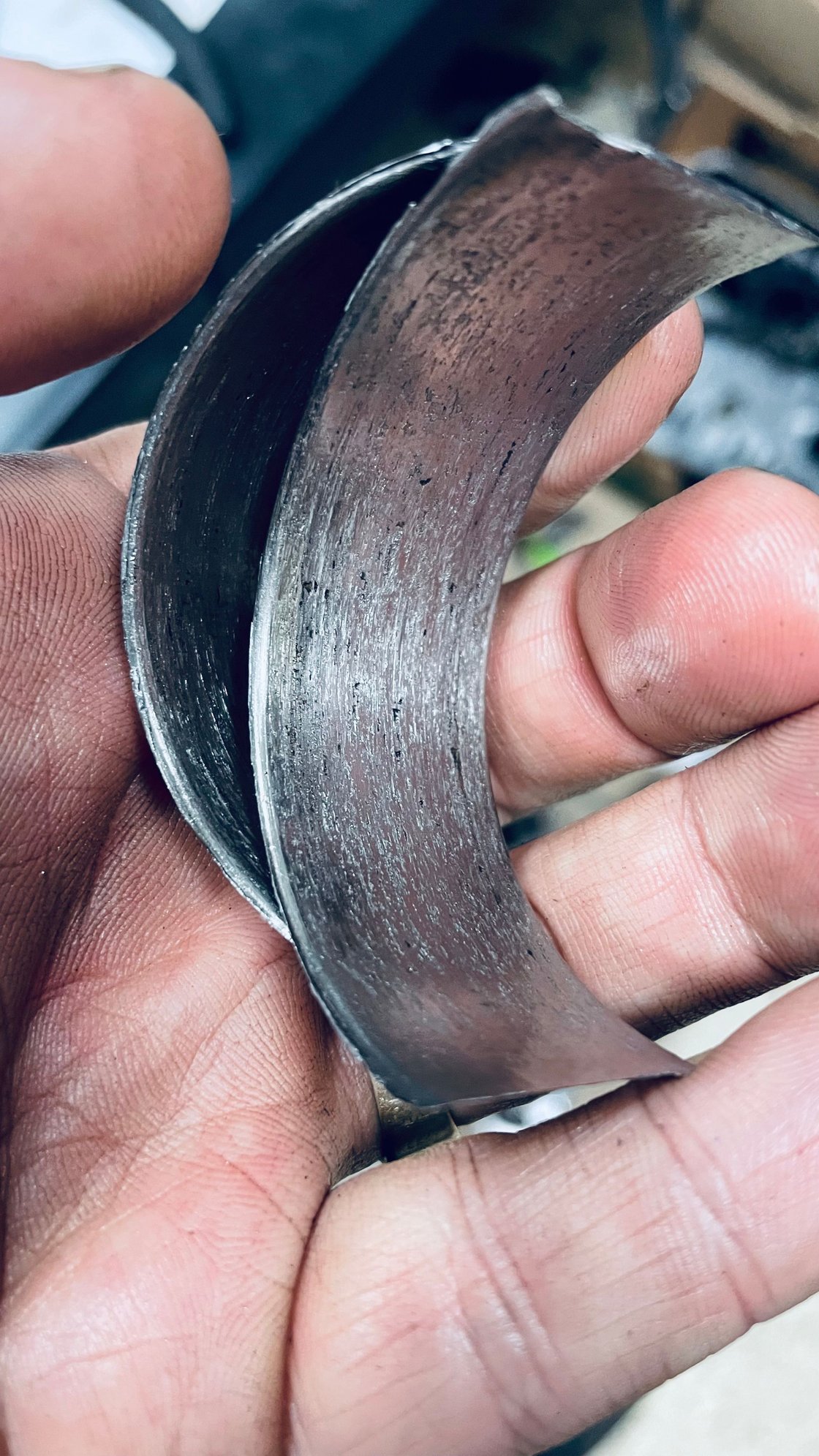

Alrighty then! Finally got the engine pulled and identified the source of the knock. With the engine upside down I put each rod just past BDC (where the piston is just starting to push toward TDC). At this point, I hit the cap with a rubber mallet; if there's a spun bearing then there will be a gap and the rod will shift, making a loud clunk. Then I confirm with another hit and it should sound solid (whether there's a problem or not).
I did them all and #8 is the culprit. All the rest make just a very slight 'pok' (to be expected). But #8 was scary loud, almost echoed. So there's my culprit.

Bummer about the toasted rod bearing....nice conclusive evidence though.
What's next? Refinished cranks and at least one new rod....
....at which point (cost), you may as well buy a "new crank.....AKA, a stroker rotating assy.

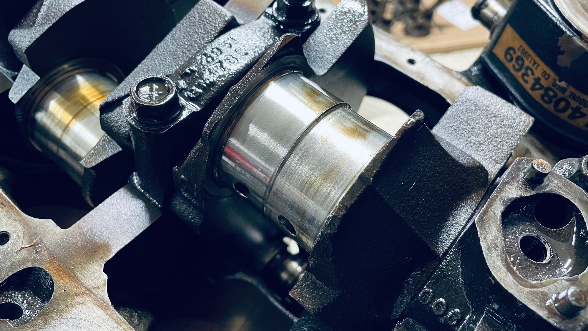

The culprit, #8. #6 is also starting to go, can barely feel some groove starting on the crank. I measured the cylinders, they're all 4.000-4.001 from top to center; although, two have a slight wearing in the outside side of the wall,

Ooof! That's rough.

I don't think is salvageable w/o welding....and at that point the cost is approaching or exceeding the cost of a new crank, no matter how good the local machine shop is.
A crank on Summit is $190.

The crank is junk, just get a new one.
