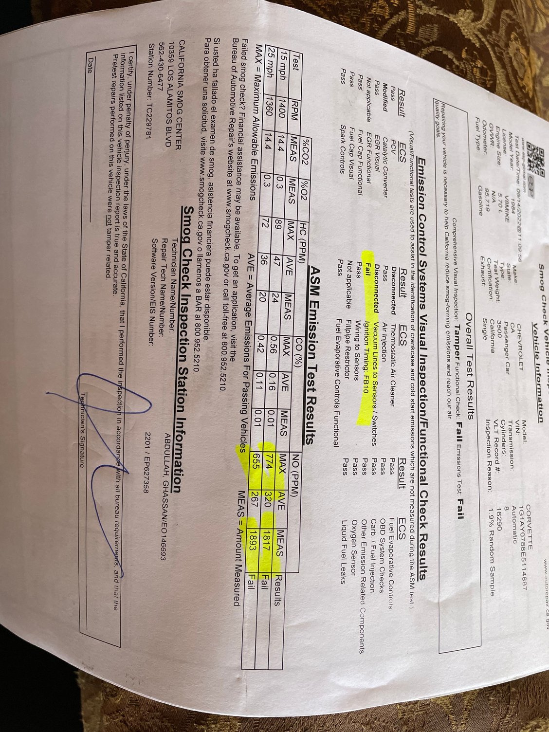

Default Update
So I tested the car again and it failed for the same reason. I replaced the O2 sensor and the NOx went down from being 4x higher to about 2x higher. I noticed the HC and CO numbers were lower than the average shown on the test result sheet. I compared these numbers to an old test where the car passed and the numbers were drastically different. I’m not sure what else to do to get this car to pass.

I replaced the harmonic balancer back in July. I actually retarded the timing a couple degrees below the factory spec. Now I’m wondering why the CO measurements are 0.01 which I read could cause high NOx.

I was a California Smog Tech for several decades, but haven't worked on cars professionally since the 90s. I used to know this stuff, but my recollection is hazy. I found this page to be a helpful refresher.
Low CO is lean, which usually causes high HC. You don't have high HC. But according to the chart in the link, lean mixture, advanced timing, and carbon build up (increased compression) are all contributors to high NoX.
I would retard the timing even more.
Check fuel pressure, raise it if possible, pay attention to fuel/air ratio. If it is lean, fix it.
Water introduced into the chambers of a running engine is effective at removing carbon. Pull a few easy to access plugs, run the piston to the top, and look at the piston tops and color for deposits. With the engine idling again, introduce water into the throttle bodies. Don't drown it out on the water, but let it ingest it. I don't know how long, how much water is needed to clear things up, but I'd probably try to get at least a gallon through it. Drive it to get it good and warm, and remove any traces of liquid water. Pull the same plugs again, take a look, and evaluate "how you did".
Just some ideas.
I'm in Torrance. I have a good test-only smog station a few minutes north of the 405 on Normandy. They will let me put a car on the machine and see how it does. I am going to go over there in the next week or so for a smog for my Typhoon. I'll ask if they would let us take a few minutes of their day to figure out your car. Let me know if interested.
Don't let your registration expire. Even without the smog cert, pay the renewal. DMV won't send you the sticker, but you won't incur penalties for late registration. Eventually you're going to get it smogged, and the sticker will automatically be sent.
I’ll try upping the fuel pressure but going to high causes the rotten egg smell and I don’t want to ruin a brand new cat. I’ve been running Lucas oil fuel additive and it seems to be helping. I’ll also try retarding the timing even more. Could I try sea foam to try and break up any carbon buildup?

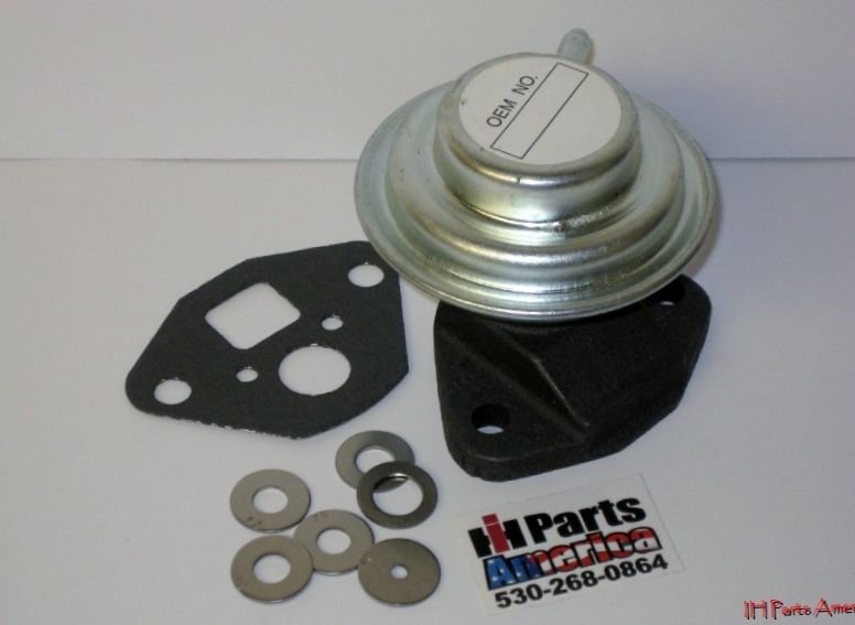

Spray bottle should work fine. I wonder if it has an aftermarket egr valve. Some of them had different orifices to tune them to the engine. Maybe it has a too small of one in it.
