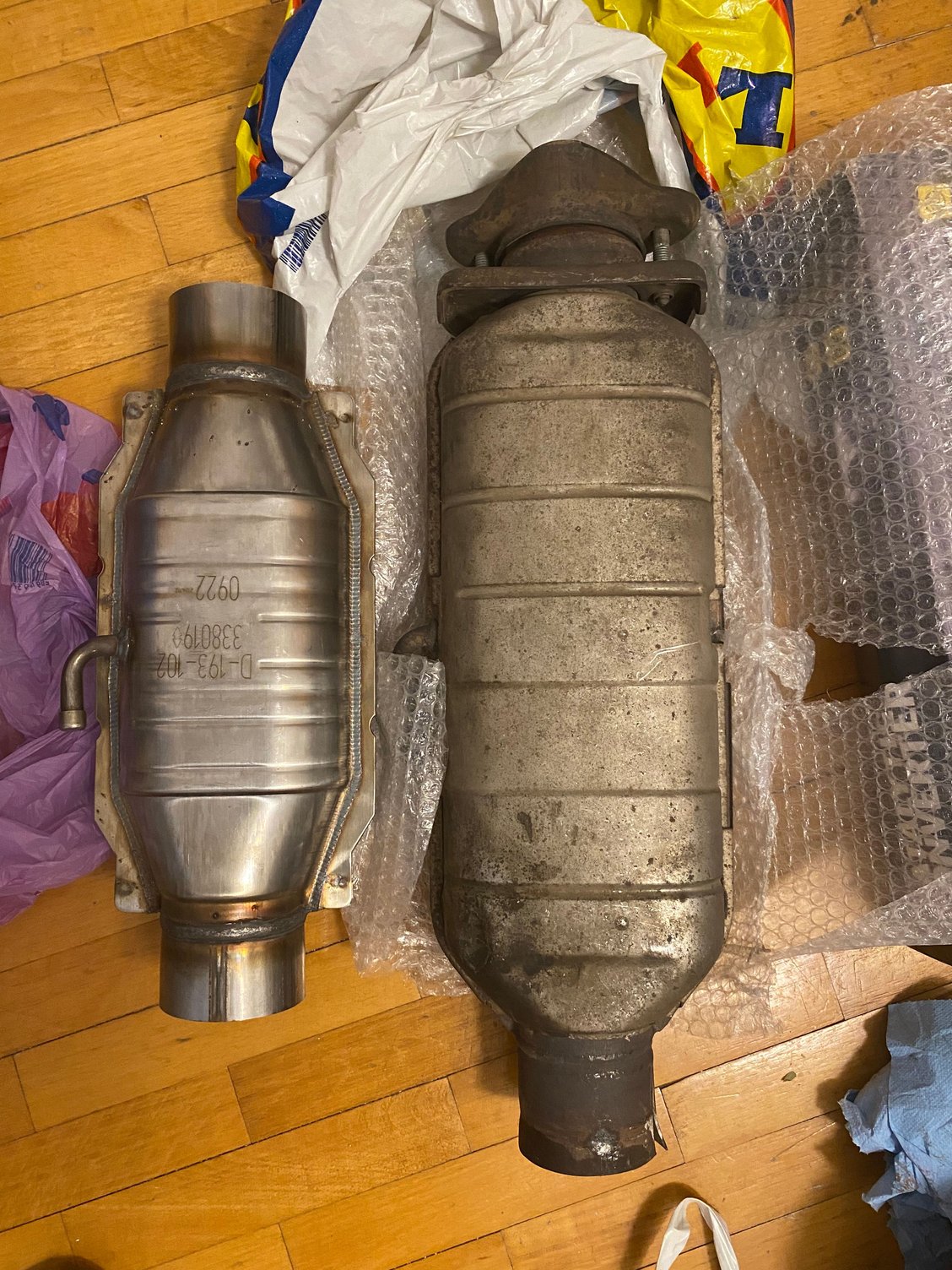

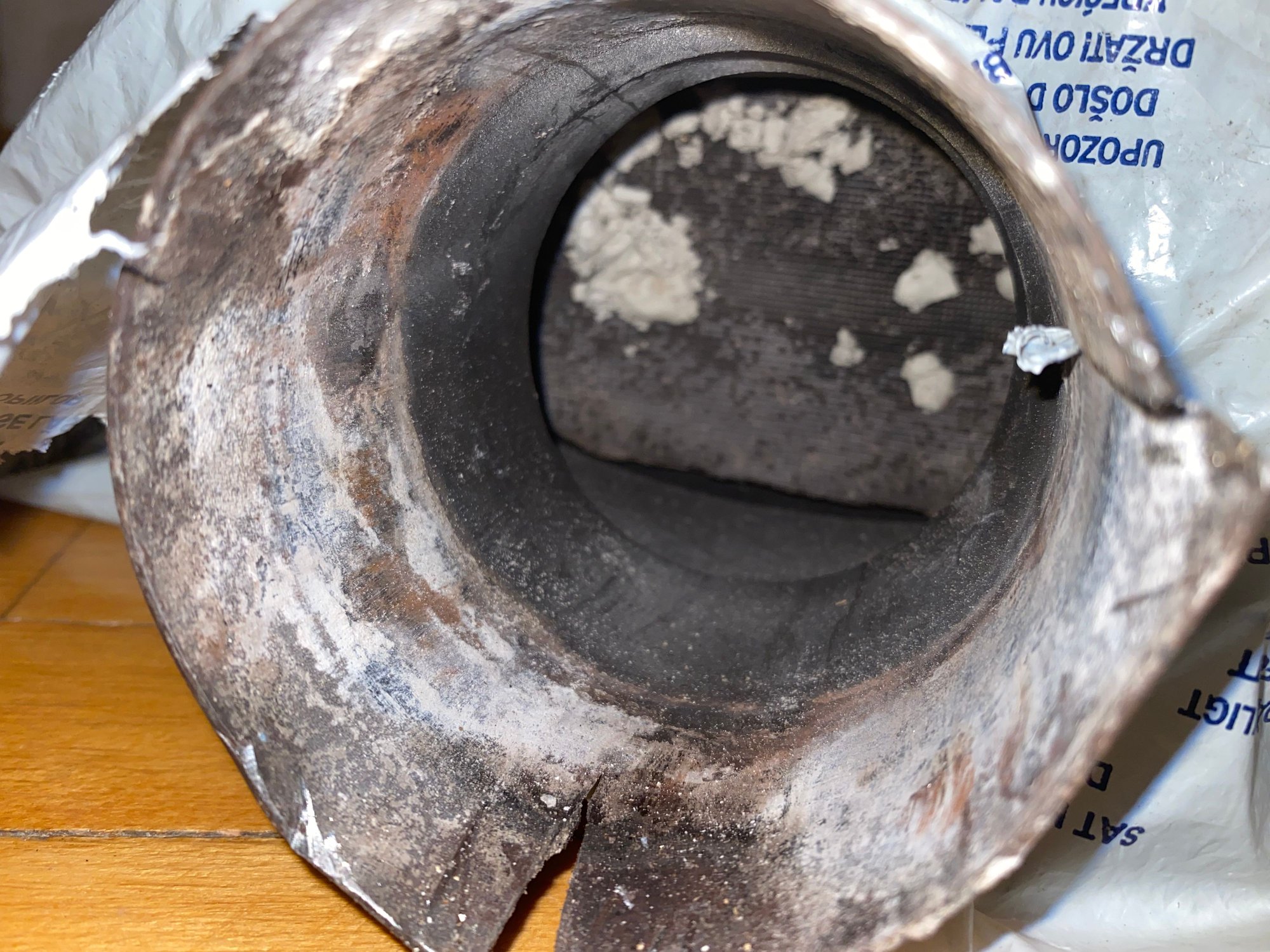

previously the main CAT was clogged then partially cleaned but after it was installed the mechanics used a sealing dough because there were some leaks. that sealing paste turns very hard and some of it ended up clogging the exhaust to the same level it was before cleaning, if not worse, with the engine having overheating problems on the track(I don’t know if the overheating is still present) and that could’ve been a possible cause.

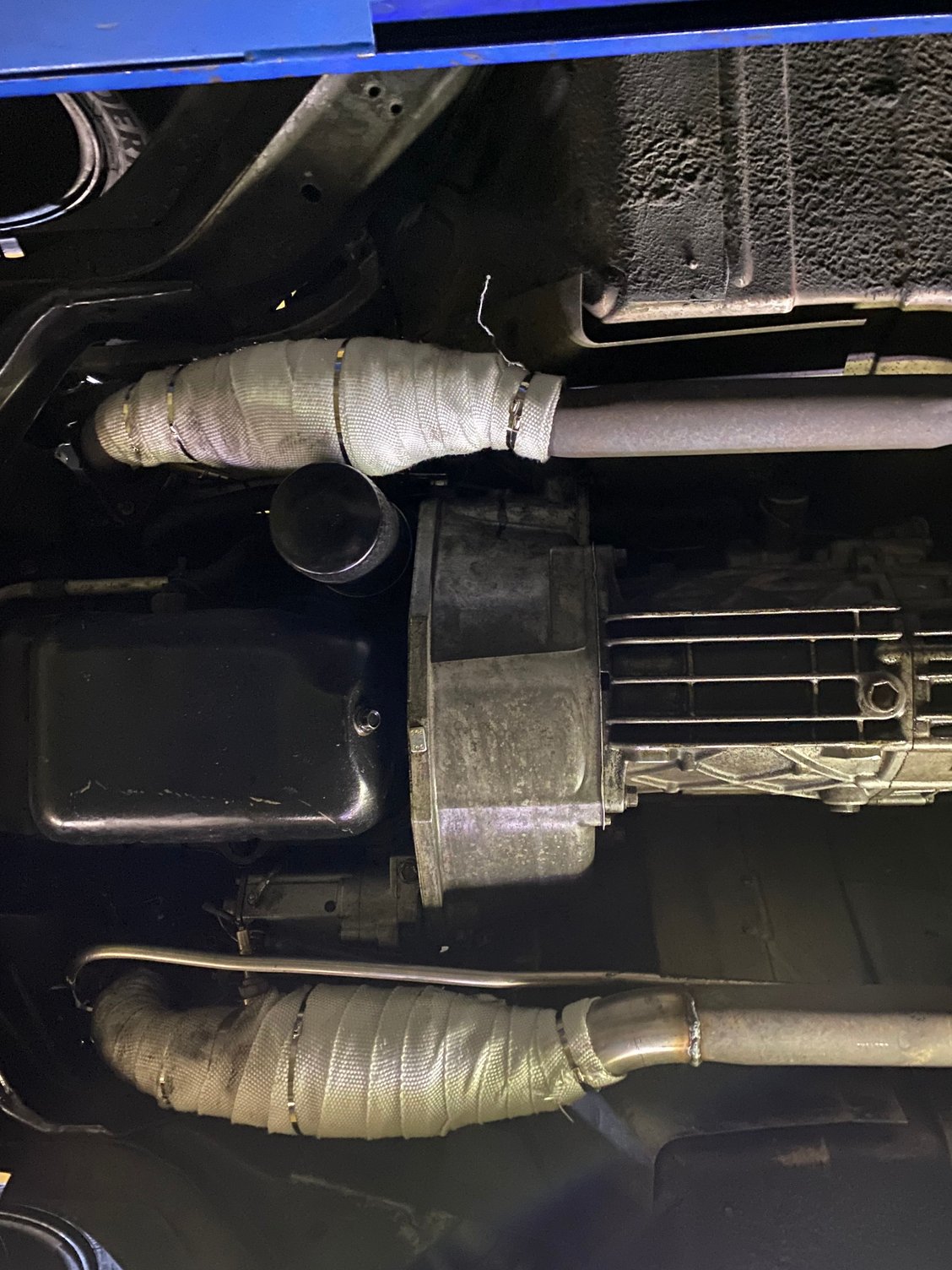

On the front I now have two FIA 100cpi converters, with such a good flow that it now sounds like straight piped (the muffler has one way straight pipe and the other muffled but it doesn’t have a flap).
Instead of the main cat now there is a free tube. and I can easily swap it for a cat whenever I need because it on VBands.
The new CAT with air tube is an MF California grade . anyway it’s much smaller that the stock. the cross section is like 20% smaller with same cpi / wall thickness. Now being shorter it may flow similarly Idk.

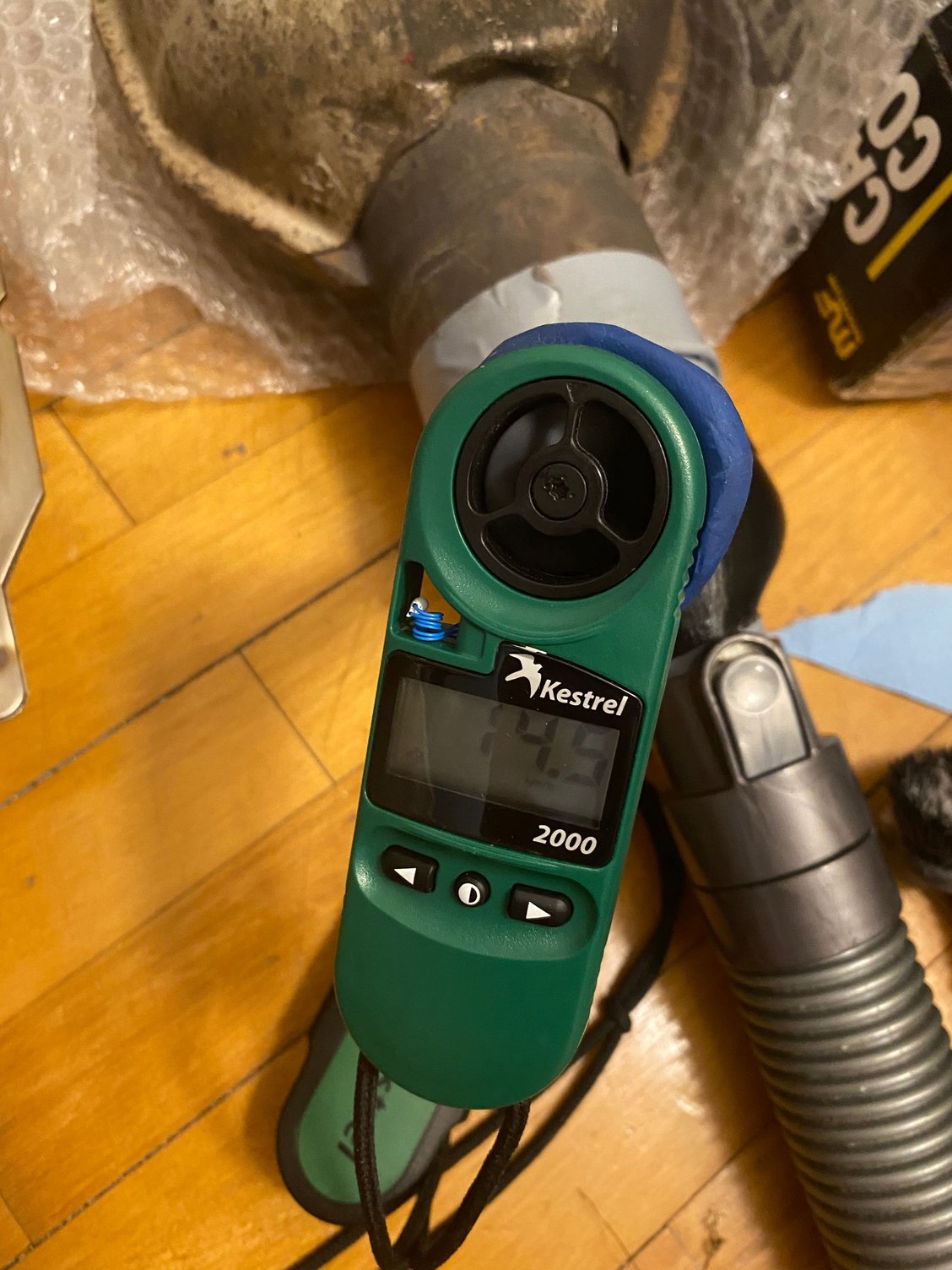

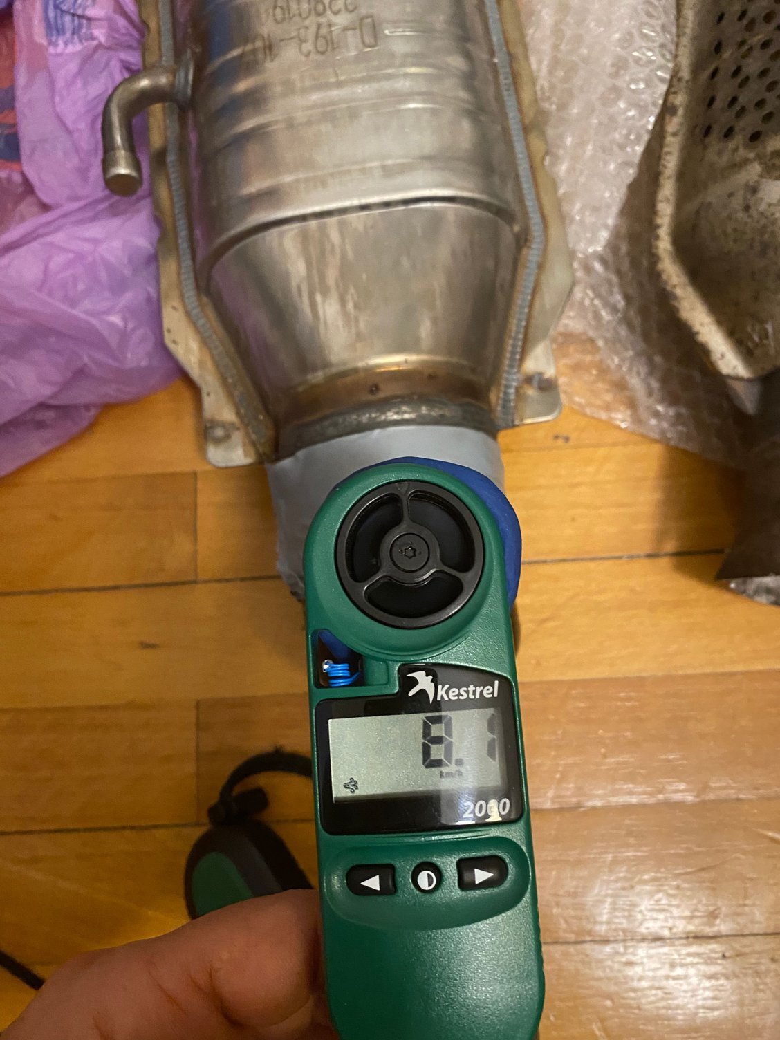

here is my DIY flow meter. The clogged CAT gas significantly less flow.
