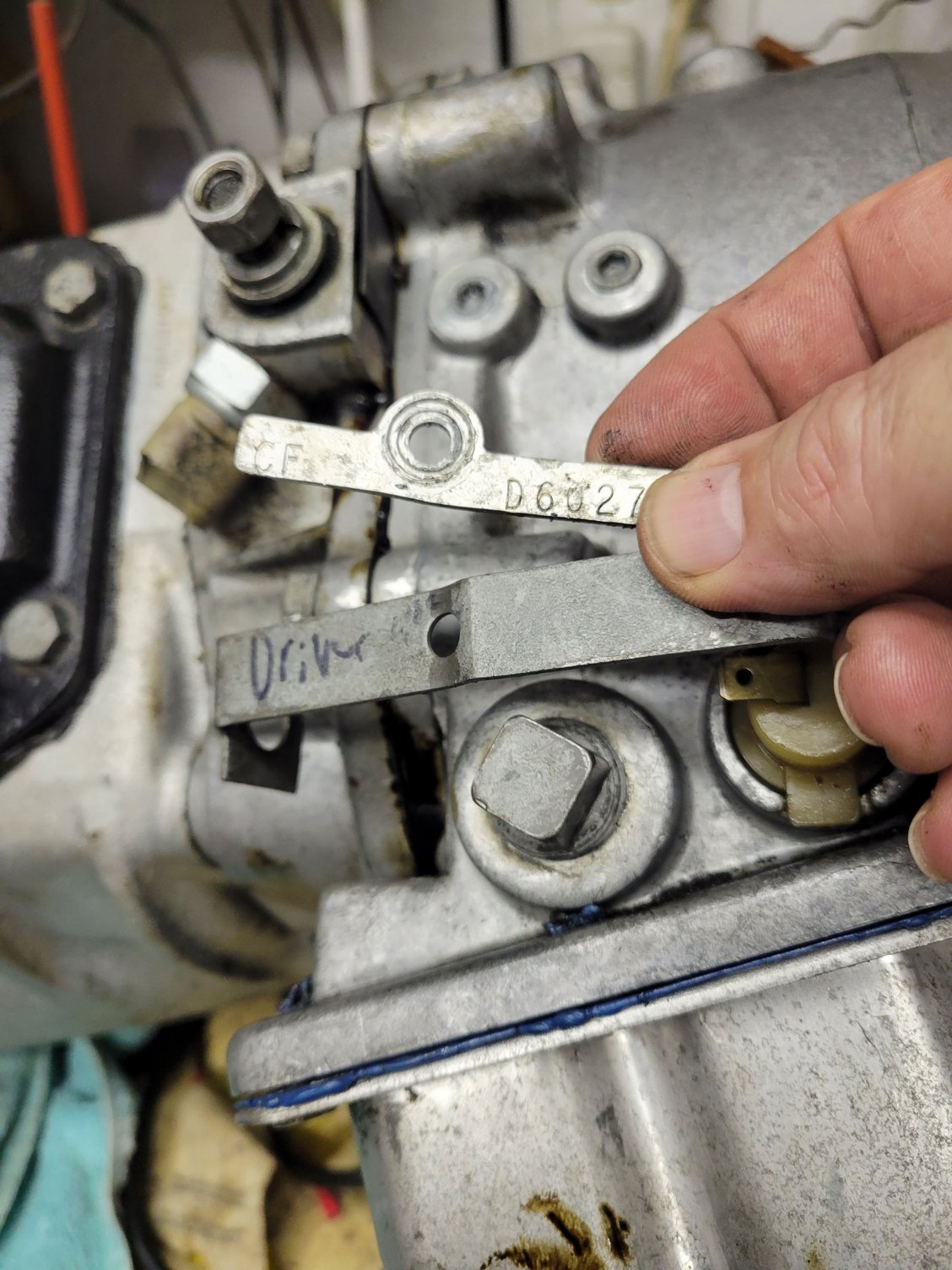

Where exactly do these brackets/tags atrach

Top one appears to be an ID tag. I would think it is held in place by a pan bolt. Second one looks like a support bracket for a wire loom or such as it doesn't look very robust. Search around for witness marks and bolts such as the side cover fasteners that match the pattern of said bracket.

The little tag goes on any OD pan bolt usually on the longest edge. The bracket goes on the large OD bolt in background of photo to hold OD power wire
