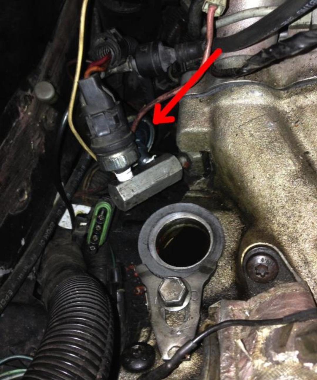

Thing behind the lower intake on an 85 round thing screwed into a pipe looking thing on the drivers side of the distributer what is it?

Its the oil pressure sender right?

Its a slooooow drip i always notice on my oil filter i thought it might be the oil cooler gasket but since its in the same general area im not sure. Need to replace the pressure switch my engine oil temps sre always reading LO., I'll just reseal the threads on the pressure sender for now since my pressure was reading ok. Is the pressure switch what reads your oil temp?

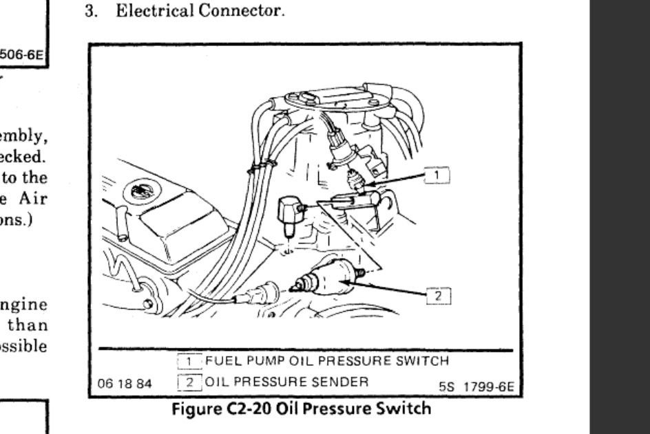

Replace both, the oil pressure switch next to it on that pipe is notorious for leaking. Less than 20 bucks.

No. Upper is oil pressure only.
The oil temp sensor looks similar to a coolant temp.
The oil temp. May have sealed or spade connector.
Especially if it was previously replace.

I think the oil temp sender is just above the oil filter on an 85. I'd replace the pressure sender anyway. Mine did the drip thing before it decided to open up and empty the crankcase.

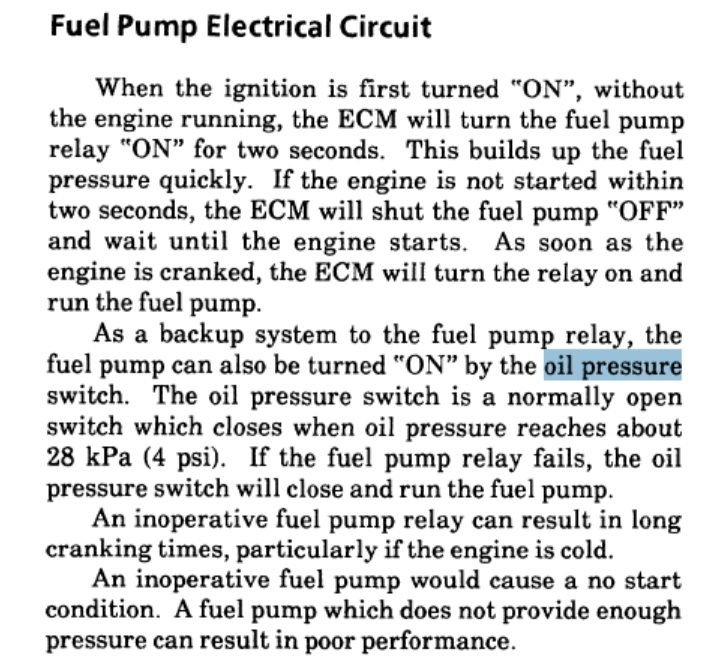

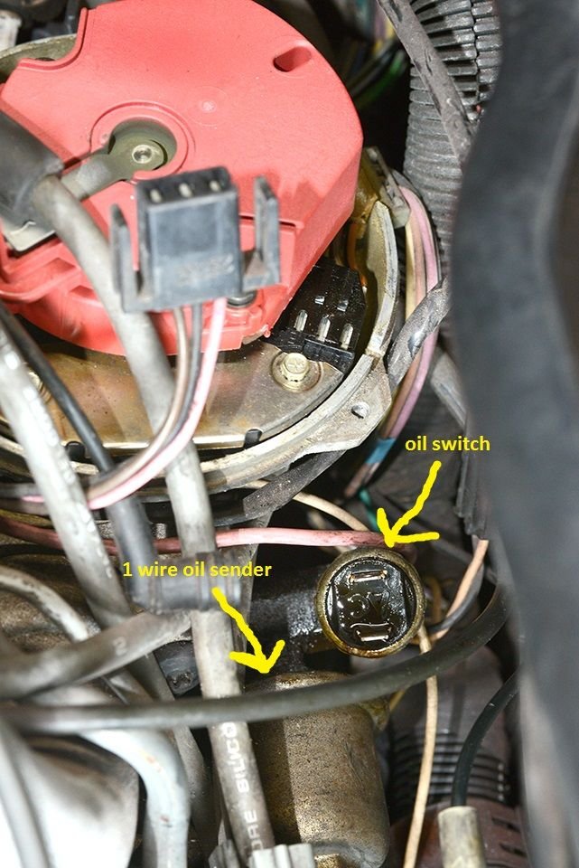

The oil switch is connected to the fuel pump, at 4 to 5 psi (cranking oil pressure) the oil pressure switch closes and supplies the fuel pump with an alternate source of power. It and many others have failed and leaked oil everywhere. The oil temperature sender is a 1 wire bell shaped device. In my image the oil switch is pointing upward at 45°, the bell shaped oil sender is lying flat.
The OP's image has an arrow that sort of points to both of them, is an 85 different ??

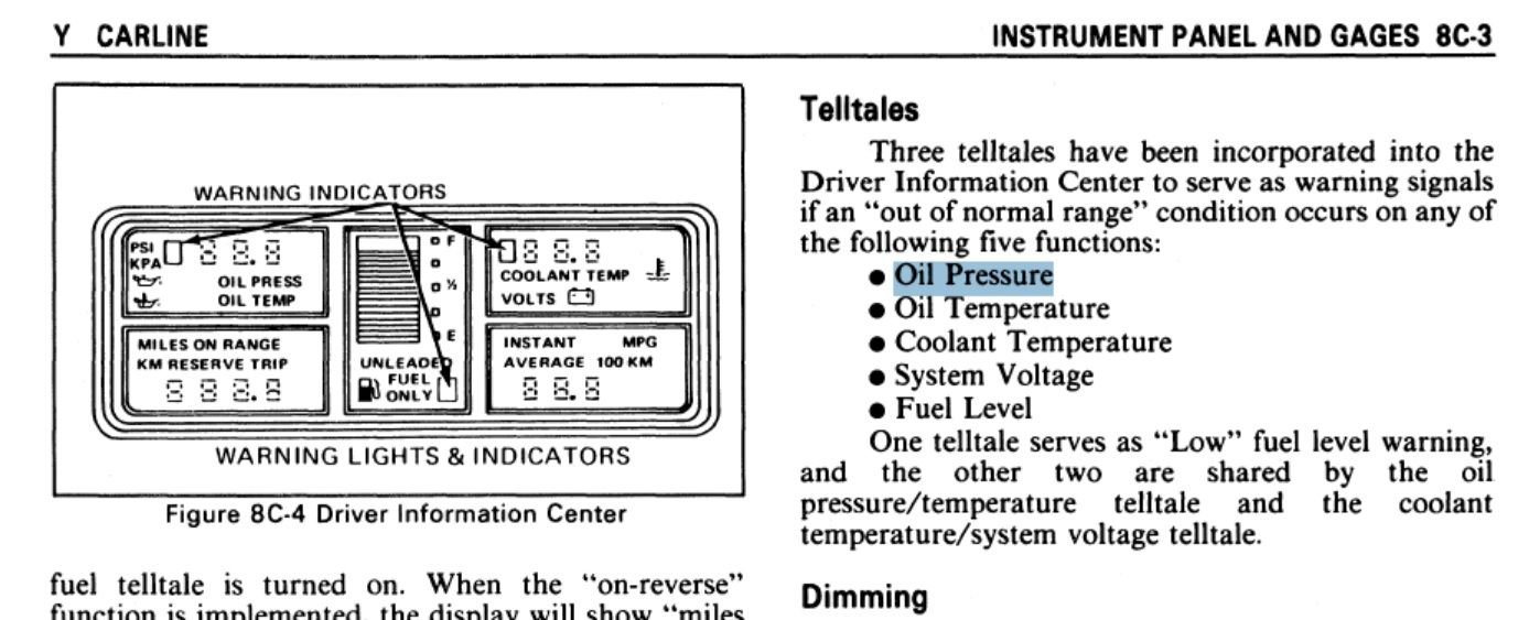

The didital dash on my 87 gets it's info from the single wire, bell shaped oil sender below the oil switch mounted on the same pipe. The ECM does not receive oil pressure, the drivers information / warning display does.
