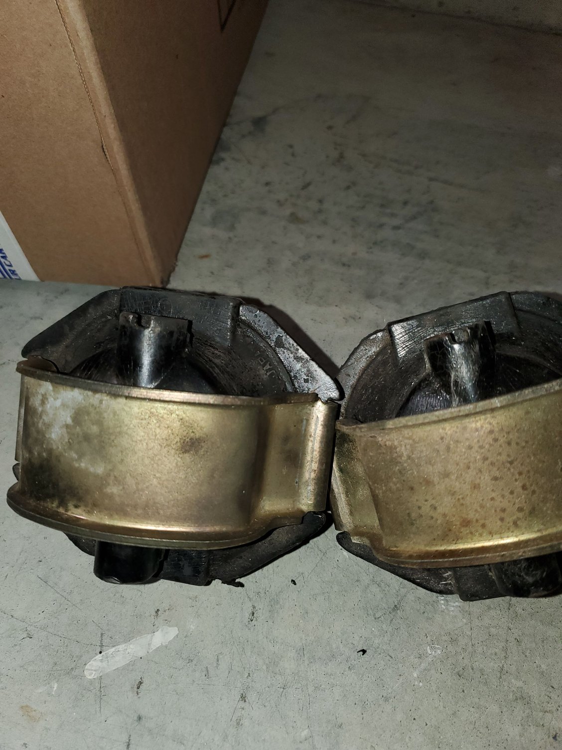

How critical are the protective blankets on the engine mounts? I know they mounts sit close to the manifold, but are the shields absolutely necessary?
Thanks

Originally Posted by rremesal
Anyone?
Without the blankets it will deteriorate the motor mounts quicker. How much is anyone's guess.
Now if you go to a polyurethane type bushing with no rubber then most manufacturers say that you can eliminate the blankets.
i did solid mounts that user Churchkey made for the forum a few yrs back
so no worries about anything deteriorating

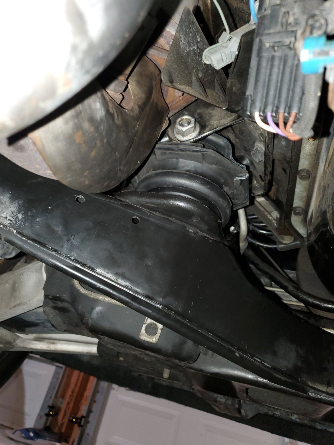

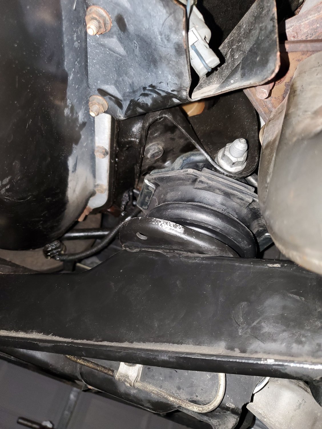

All,
I had a hell of a time trying to get the driver side mount in. I struggled for about 2 hours. I finally realized I had the mount facing the wrong way (180*).
Noticed in the picture below how the top of the mount where the bolt goes through, there is a groove that mates with a notch on the engine mount bracket. If you have it backwards, the mount will never slide in to place.
The passenger side took me about a minute yesterday. However, notice how the passenger side sits a bit offset on the base. Is this what you all have seen as well?
Notice the groove where the bolt goes through.
Passenger side
Driver side... It sits more centered than passenger side. 😐
