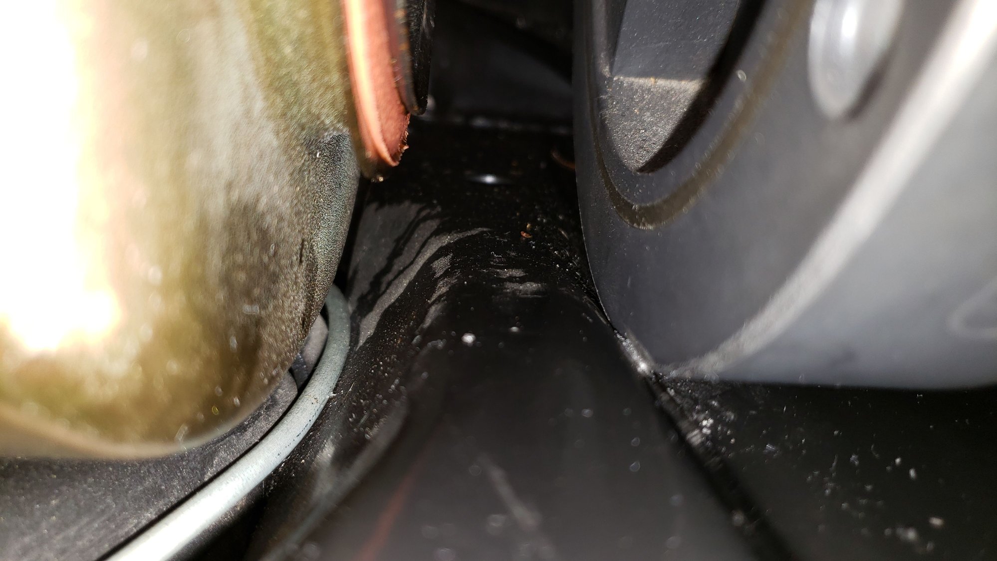

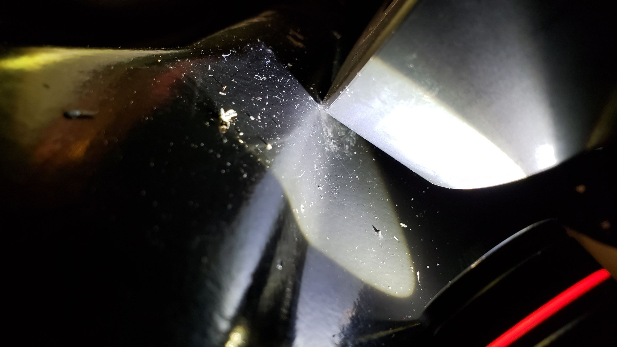

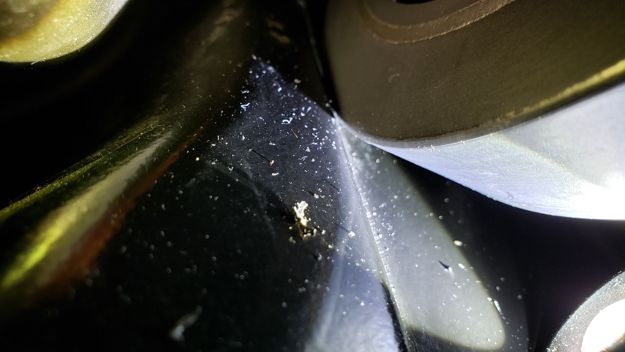

88 with a 383 and 700 trans. 8" balancer....entire suspension is new and motor mounts..<500 miles on entire build.
So this year id have a weird noise when it started cold. After about a minute tops it would go away...took belt off and it was still there. This is what I found....
I can think of 10 things that might cause this. i didnt wanna post this until I dove into it a little more, but figured I'd see what anyone has to say....im winterizing 200 boats so I'm busy as hell, but this weekend I'm gonna try to get balancer off...I was hoping maybe something fell in there but can't get a good pic until crank pulley is off...
Was hoping to get more miles this year before it gets too cold, but looking not its not gonna happen...

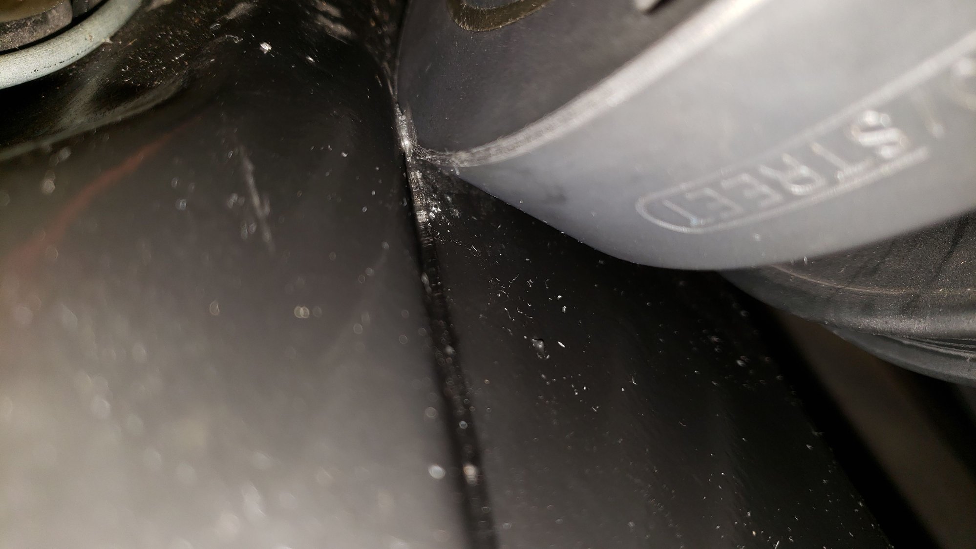

Balancer just touching....and i mean just

All I could think of is the crank naturally wants to move forward.. so that would be a very worn thrust bearing on the crank......its just touching the ridge on the k member. And funny I even saw it as the paint on the balancer is barely scraped off..thats why I hoped something got pinched in there but don't think so.

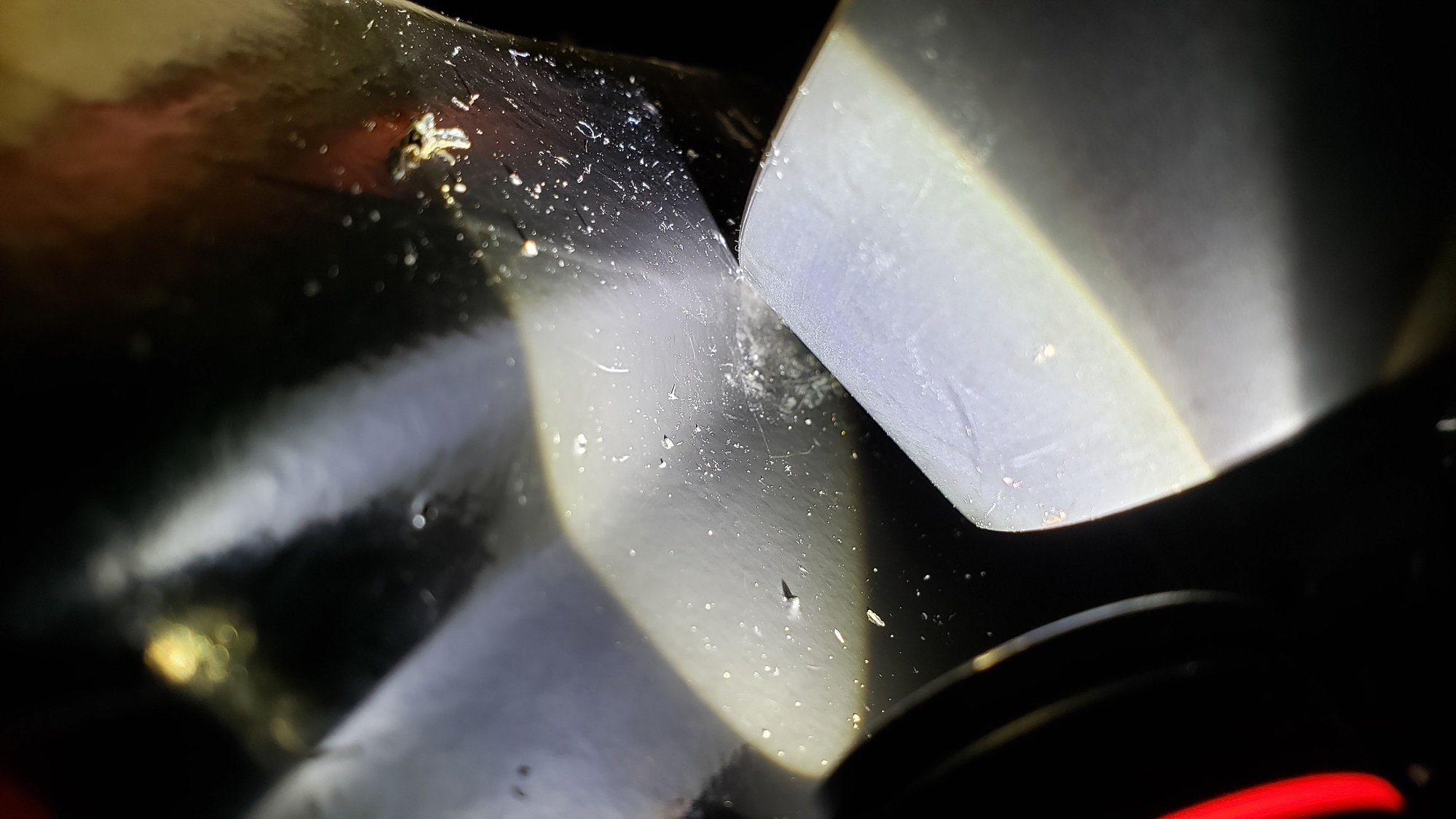

Only pic from my borescope before it died...those chunks are actually tiny flakes.
