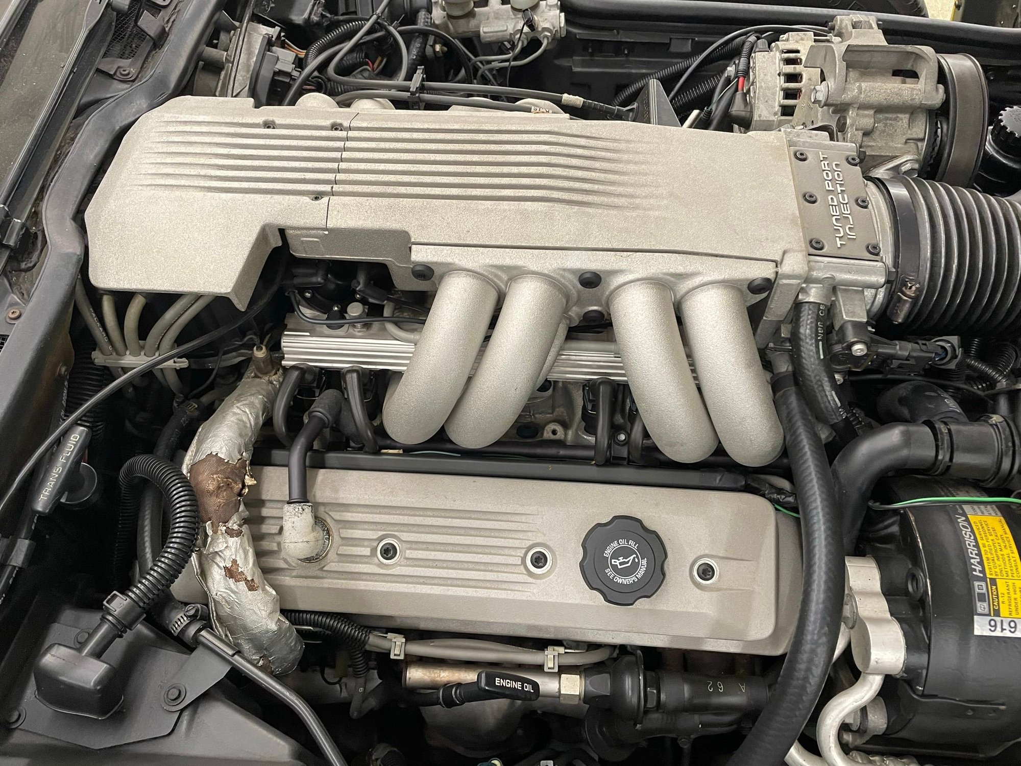

I’m in the process of purchasing a 7k mile 86 convertible that has been a museum piece the majority of it’s life. The car has been stored on a showroom floor the last 3 years and has not been started in that time. A new battery has been installed and it just cranks, no start. Fuel gauge reads full and you can slightly smell fuel from the pipes, as well a an engine stutter from time to time as it attempts to run. They have a tech on site who believes it may be the VATS, but I am unsure of that because the motor will turn when the key is turned. I’m no expert on VATS though. Only 1 ignition key with the cars and it appears like new. I’m thinking fuel pump or empty gas tank with a bad gauge. According to the owner, the car ran beautifully 3 years ago when it was parked and displayed. I’m looking for some suggestions on where to start troubleshooting.

Semi. Congrats!
That is one pristine vert.
Ok your details rule out VATS.
Due to the fact the starter turned over. Engine tried to fire.
You can do a simplistic test. Press in the valve stem on the fuel rail port. Should spray fuel.
If you have a fuel shower.
Next get a fuel pressure gauge.
Check for pressure at key- on. No start.
The needle should snap above 45 and hold a constant 43 - 45lbs.
Keep us posted.
