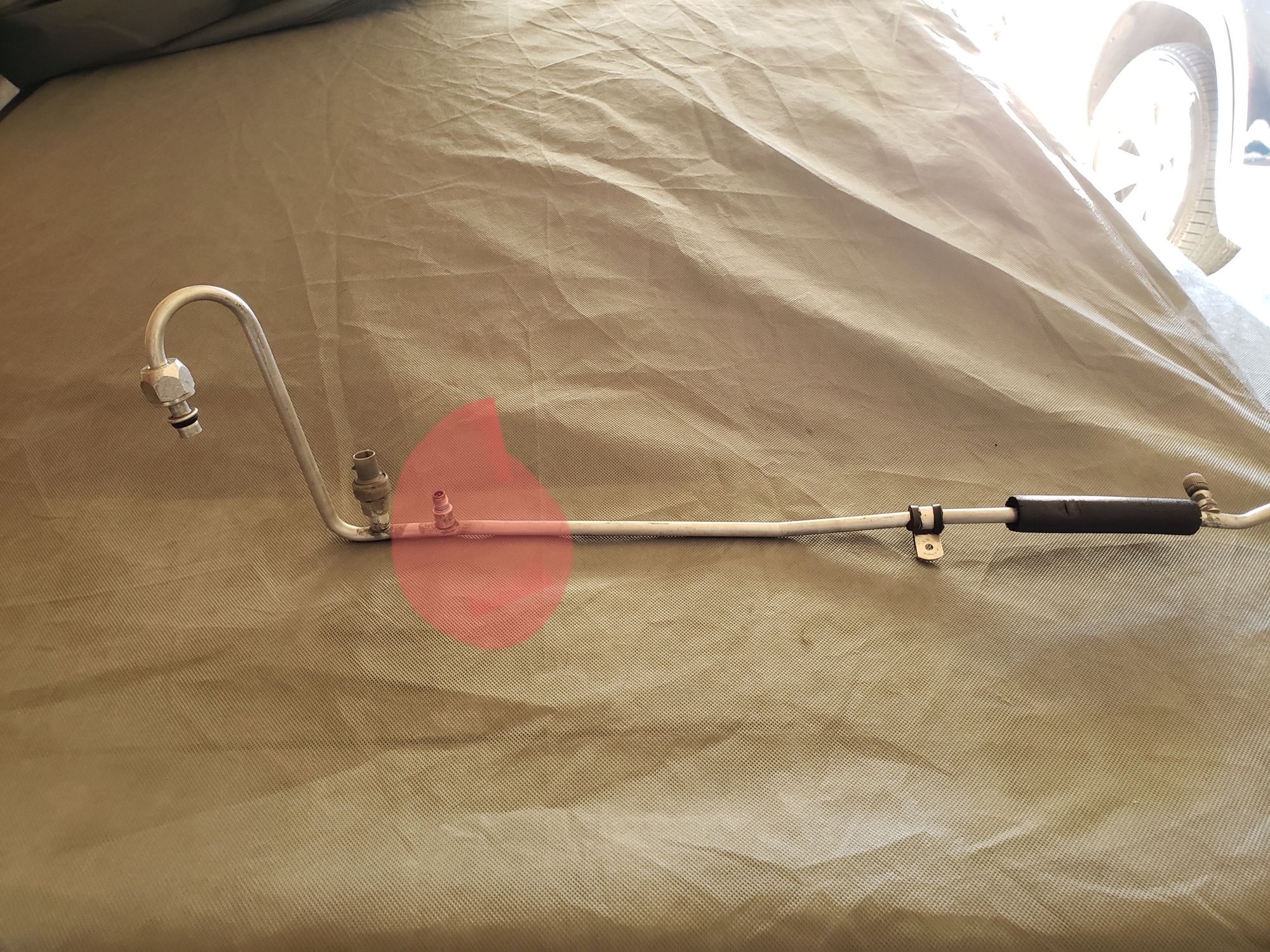

1985 a/c line, need a name of this part or part # please.
HI All -
Can anyone tell me the name of this part. Our mechanic calls it a binary switch, which gets me no where. Also have tried high/low pressure switches which are definitely NOT correct.

GM 14078970
Air Conditioner Compressor Engine Coolant Switch Assembly
The port to the right of the shown switch is for the cycling switch 10007057
The entire tube is 14081366

I believe. 1985-1987 A/C 6 Condenser to 8 Evaporator Liquid Line
