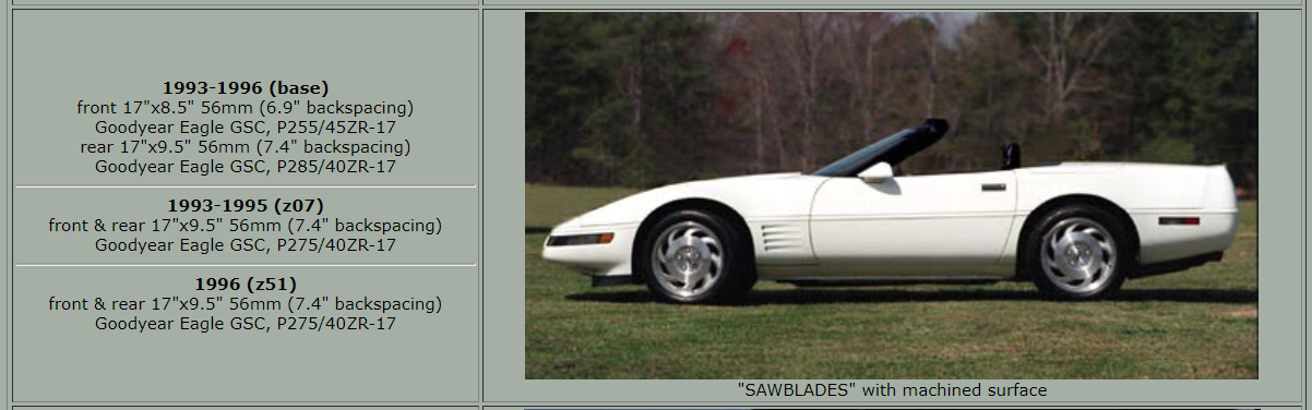

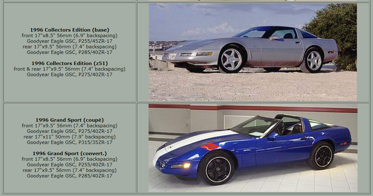

Offset 56 mm.
Width 8.5" or 9.5"
Diameter 17" or more if you select lower profile on the tires to keep outer diameter correct.
Minor offset change is ok, but use your current wheels as reference.
10 mm less offset will push your rims out by 10 mm on each side.
Increasing width by 1 inch will ad 1/2 inch on inside and 1/2 inch on outside of rim.
https://www.joby.se/corvette/div/corvette_wheels/

Originally Posted by JoBy
Sawblades are not stock on 1996.
Uhhhh, yes they are. They are definitely the stock base model wheel in 8.5/9.5 "staggered" widths.
Later-gen Corvette wheels have the same bolt pattern and hub bore, so they'll bolt up. They generally have more offset in the rear. You can work around this by using spacers to push them out to around the stock C4's net offset. The C8 wheels are a different bolt pattern and will not work properly.

Yes, you are right and I misread my own page made it many years ago.
1993-1996 base was a bit up from the 1996 A-molds
