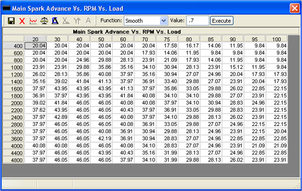

Sorry no help here...here's the lower spark map table for AXCN. If you really think that's the issue, you could pull back a few degrees on the initial 6* to see if it improves. I can't remember what has been done from the beginning of your issues but if everything in the ignition system is allegedly new i.e. cap, rotor, wires, plugs, ICM, coil...I seem to recall reading in a magazine's "tech section/what's your problem" and the response to customer's missing ignition issues from a former GM tech "hail Mary pass" was to swap in a new distributor. I'm not one to blindly throw/swap parts before troubleshooting but allegedly, the one last component would be the pickup coil.

^That is showing 46* in cells, so maybe the OP's problem isn't the tune.
OP, verify your timing mark on the damper. Perhaps it's slipped and you've actually set the base timing quite a bit further advanced than the 6* that you think you set it at?
