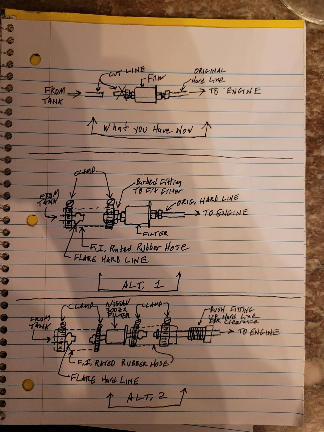

Here's a few drawings of how I see your options regarding the fuel line/filter.
These are not to scale, of course. I drew worm clamps, but I would recommend using fuel injection clamps, which are available at any parts store.

Nice pics but the barbed fitting would have to have that o-ring boss on the other side for the filter. I am hoping that Domans 800-170 has the right size threads for the filter. I believe so at 16mm.
