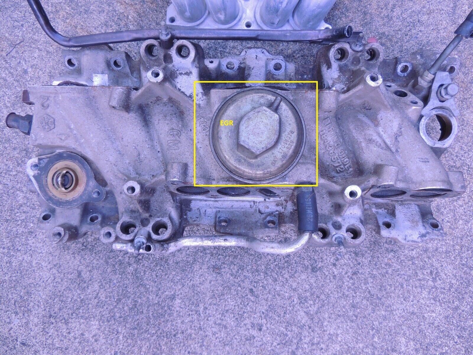

What goes where the broken fitting is and the hole to the right of it.

The broken fitting was a nipple for a small coolant hose that goes to the heater hose. The hole to the right is for the egr.

Its not the egr, that is in the center of the intake manifold. I have the factory parts book but it does not show the right side of the engine.

Just for what it's worth, I have an 86 with iron heads and mine has both that same EGR port and the tiny coolant pipe (only on one side).

I'll 2nd what x86 said. My iron head 86 has the same intake.

So this manifold has an EGR in the center of the manifold in addition to the side port.
Questions:
1. I believe this came off a 86 car with iron heads. Can I run it on a 85 with iron heads?
2. Anyone have close up pics if their 86 with pipe or EGR to that area
3. If I run the center mounted EGR can I block off the side port?
Old Dec 6, 2022 | 08:25 AM

What is the casting number? That would be the correct way to actually ID what you have.

Dont have it in front of me but I am 90% sure I pulled it from an 86. Here is a pic of an 87. The big question is can I run an 86 manifold on a 85. A close of pic of a complete 86-88 would be nice.

Post #11 is a '86 or later intake. That EGR # changes to a number that fits '86 and later but '85 is single year intake and one year EGR, '86 is single year then '87 & '88 are the same. If you have a parts catalog the information is there.

Thats is good to know, so I will buy an 86 EGR valve BUT the hole in question appears to be for a heat tube, Not to sure where it goes or if I need it. Or if I need the EGR at all. Maybe your 86 parts book shows where the tube goes.

Sorry, we should have been more clear. The tube from the passenger side exhaust manifold goes to that hole on the back/side your intake, which internally then goes to the EGR valve on the top/center, which will open and close under certain conditions to allow the exhaust gasses to be recycled into your intake air. So when we say that's an EGR port, we just mean that it's part of the same system. The tube you show in the pictures looks just like mine (as far as I can tell) so I have no reason to doubt that it'll bolt up. But you can delete that whole EGR system with a couple of block off plates. I'm about to do the same as my new headers do not have an EGR tube.
If you block them off, some people have reported seeing the check engine light come on from time to time, and others have said they haven't seen the check engine light come on at all.
There are ways to program it out of your ECU so that you don't get a check engine light, but I can't be much help with that part as I haven't done it before. You'd need a new PROM chip for that.
