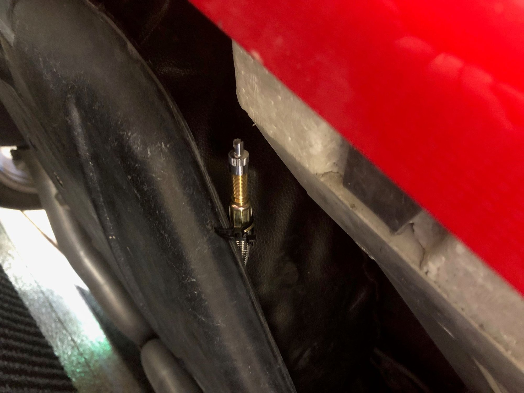

I did the same a few years ago. I also added an extension of the stem to be able to check the pressure without dropping the tire. Dan
