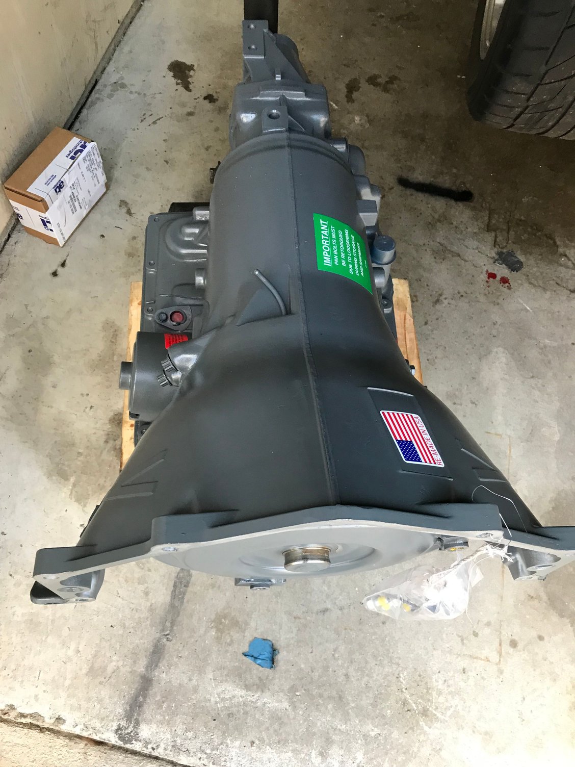

Thanks, got some good advice on removing my 93 auto came right out , had to remove one side header (Long tubes) that was about as much work as the trans removal, I used my jack, and a plywood gravity was my friend but going back going to buy one of those trans jack adapters deals looks like all I will need one time deal (I hope) Ok any advice on the reinstall .Thanks

Originally Posted by IHBD
Dipstick tube has to be installed into the case before the trans is up all the way.
Be sure the torque converter is fully seated onto the trans snout. The final dimension is about 1/2" between the converter and the pump mounting bolt heads.
You might want to be sure the new converter indexes into the crank snout, although I've only encountered a problem here once in many, many, installations.
When the trans is in place, check that the converter still turns freely. As long as it does, it hasn't slipped forward.
Check that you aren't pinching any wires between the engine and trans.
Don't draw the trans to the engine with the bolts. Get a couple of the lowers started, and you should be able to push it onto the dowel pins and flush. Then tighten them.
There's some little things to watch for. You'll get it.
Thanks all the info all the info it all adds up not a auto guy stick guy but not like some don't know it all yep been working on these old vettes for years. the converter will come installed will do all I can to keep it there .. The dipstick yep crazzy Thanks .. I could not pass this auto C-4 up it was taken apart and painted very quality paint job worth more that I gave for it all new insides and on and on $7,500 so I got a auto lasted 3 years .. 140,000 miles Thanks
just waiting on the Jasper trans guy to it off sometimes today any advice on the rinstall ..Thanks

More than once I had the trans bolted up and realized that I didn't insert the dip stick tube. It's a lot easier doing it when the tranny is not yet in place.

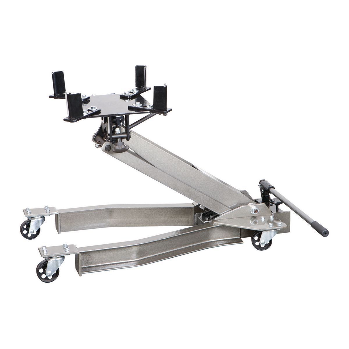

This thing was expensive (even at Harbor Freight) but it's worth every penny. I can't express how much easier it makes putting a transmission in when you have ***** the will adjust the angle of the trans in any direction. I just wish it went a little higher.

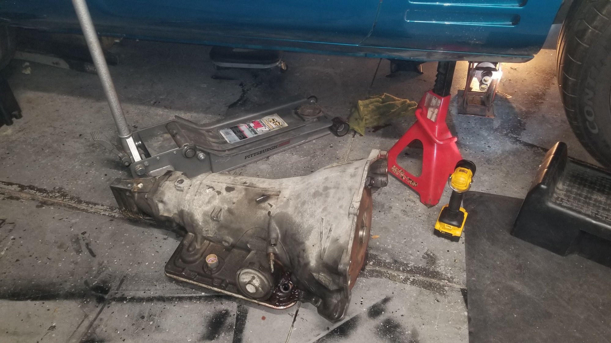

radar502, I have the same car, same color, and same floor jack. LOL. just pulled my tranny.
Good deal my trans made it 140,000, taking out not too bad going back a trans jack will be your friend for sure. I had to remove the bracket on my filler tube just would not go in maybe halfway other than that the reinstall was not too bad. Good luck with it.
