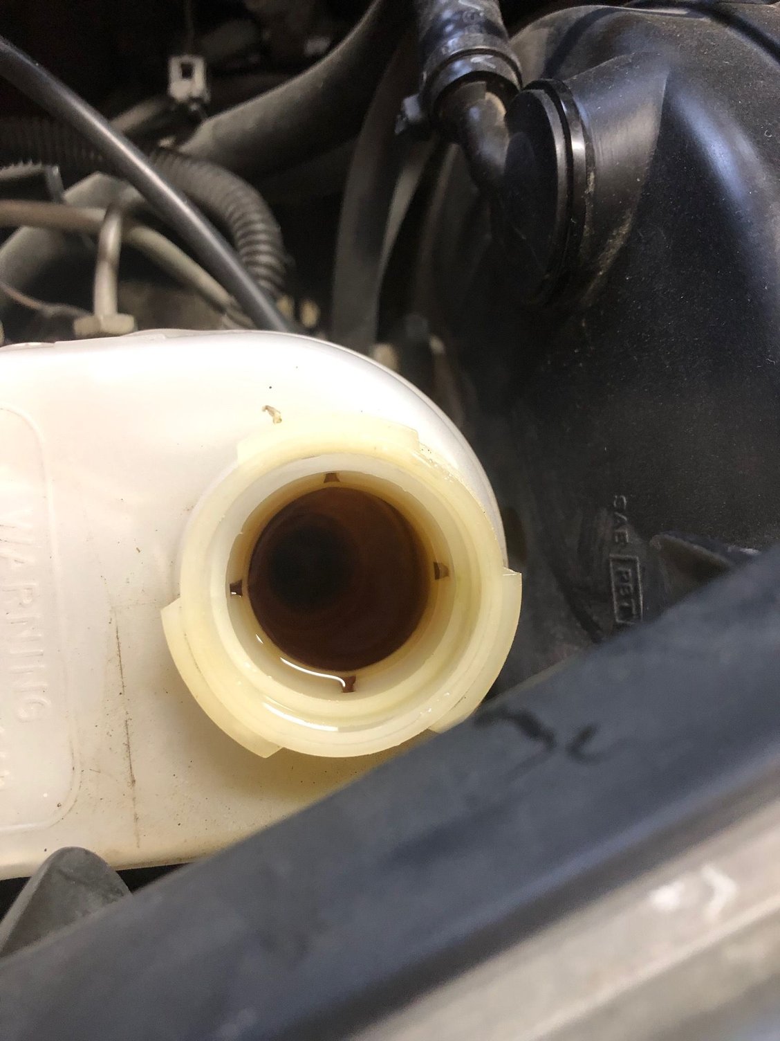

I have asked this question before and never got an answer that made sense to me. Maybe somebody who really knows for sure will see this. I have a 96. I have seen the posts that showed the screens in the ABS pump clogged and it did not seem like there was much flow. I know that a normal brake system has very little flow when working. My question is: If I do a normal brake flush at each wheel does the new brake fluid flow through these screens that clog in the ABS? Or does the ABS have to be activated to get any flow through the screens? If I knew for sure it did I would do a four wheel flush way more often. Thanks very much, Dan

Well, I flushed the hell out of it. My wife hates to pump the brakes to flush so I bought 4 Russell speed bleeders. The speed bleeders worked great for the flushing but I could not get them tight enough to seal when done. I was not about to snap them off in the caliper. Sending back for credit. They looked like they were only touching on one side of the tapered area like maybe not machined correctly. I put the originals back in (sealed right up) and talked the wife into doing 10 pumps per wheel so if any air went in putting the old ones back in. Super firm pedal. Thanks for reading, Dan
