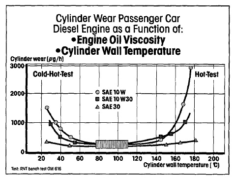

Originally Posted by IHBD
This chart (from Tom cfi's coolant temperature thread) disagrees with you. The straight 30 protects better at both ends of the temperature 'bathtub' than 10W30. Over decades of building and maintaining my engines in several applications, I saw differences in bearing wear between 10W30 and straight 30 in the SoCal ambient I typically operate in. "Numbers" and "Specifications" are fine, but empirical results are also valid.
You can disagree all you want. However:
  • Your original post that I replied to implied that "a 0w" oil won't protect the bearings in a large-clearance, older engine as well as a straight 30w. I pointed out that it's really a 0w-40 being compared (not a straight 20w), and that at cold startup (where the "0w" part of the grade applies), the 0w-40 still has many times higher viscosity than any oil at operating temp. Once both oils are up to temp, the 0w-40 has greater viscosity than the straight 30w and will protect better (all else in the two oils being equal).
  • My other point is that at cold startup, the 0w-40 will flow much better than a straight 30w and will therefore protect the engine better because it reaches the wear surfaces faster. This is indisputable.
  • The chart you posted has nothing to do with either of these points. It isn't talking about how fast oils flow to wear surfaces on cold startup. It's also talking about the temperature of the cylinder wall (and coolant) rather than the temperature of the oil. Big difference there.
  • It also looks like it's 50 years old and comparing a straight-weight dino oil with a multi-vis dyno oil that uses lots of additives to a 10w base to get its multi-viscosity rating. That's ancient history. The good modern synthetics aren't made like that at all, and protect vastly better than any of the oils in that chart.
