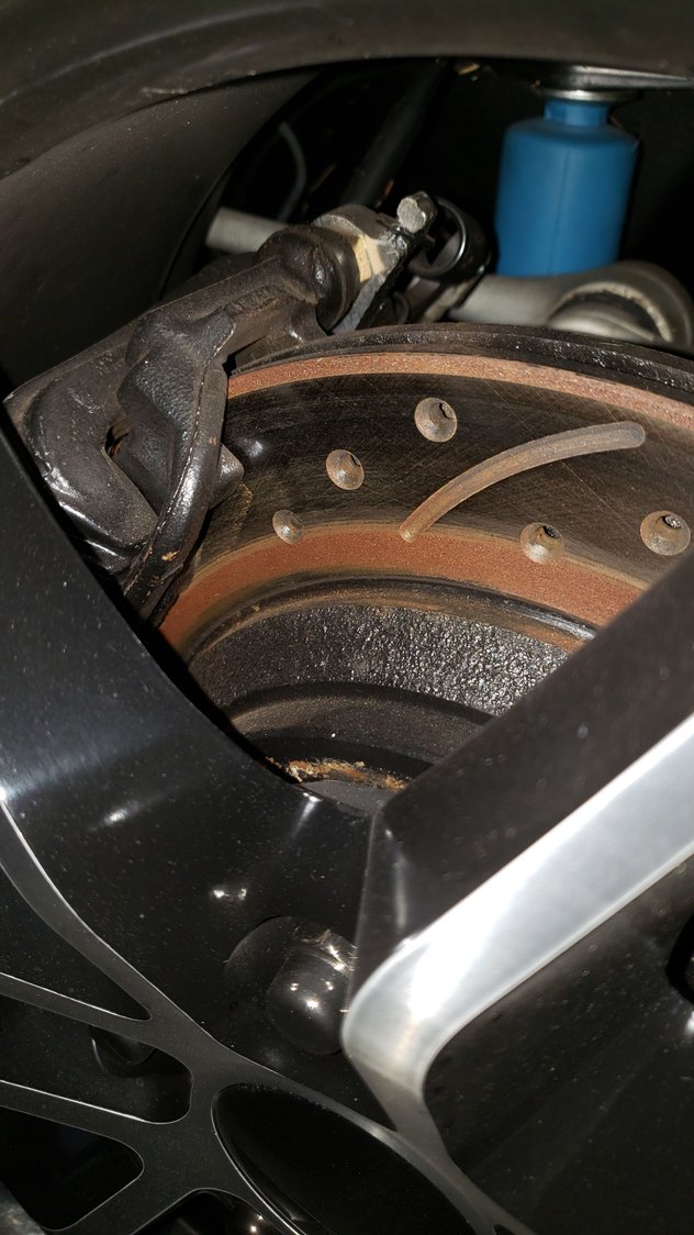

This is the drivers side rear of my 88 for reference if this helps at all....I took the pictures as its easy enough to see through the wheel...
Someone mentioned the sweep of the pad on the rotor..i agree, i always thought it didnt look right....

The rotor isn't on straight. Look at the mark on the hub next to the rotor. It's covered up on the right side of the picture and, as mentioned before, differing amount of threads showing on different lugs.

that was before and it was straight when I did the leg thing. thanks. Also discovered a stripped stud so havining that taken care of tomorrow. Never know what you will find on a 31 yo car

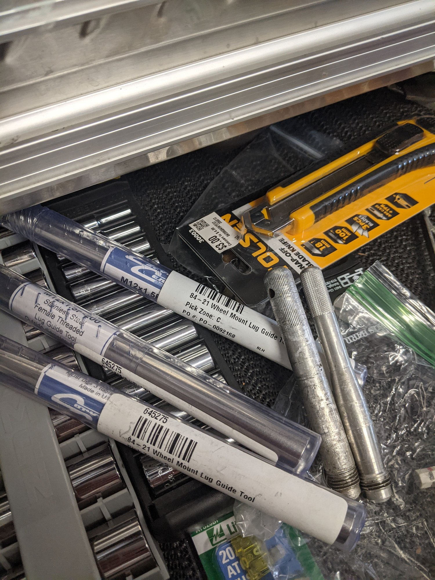

My days of bravado are over. I use these on all my cars, every make. I use three on the c4 because the wheels bring the meat!

Where did you purchase these?
Corvette Central
https://www.corvettecentral.com/c7-1...nt-tool-645275

Do these screw onto the wheel studs?
yep.
