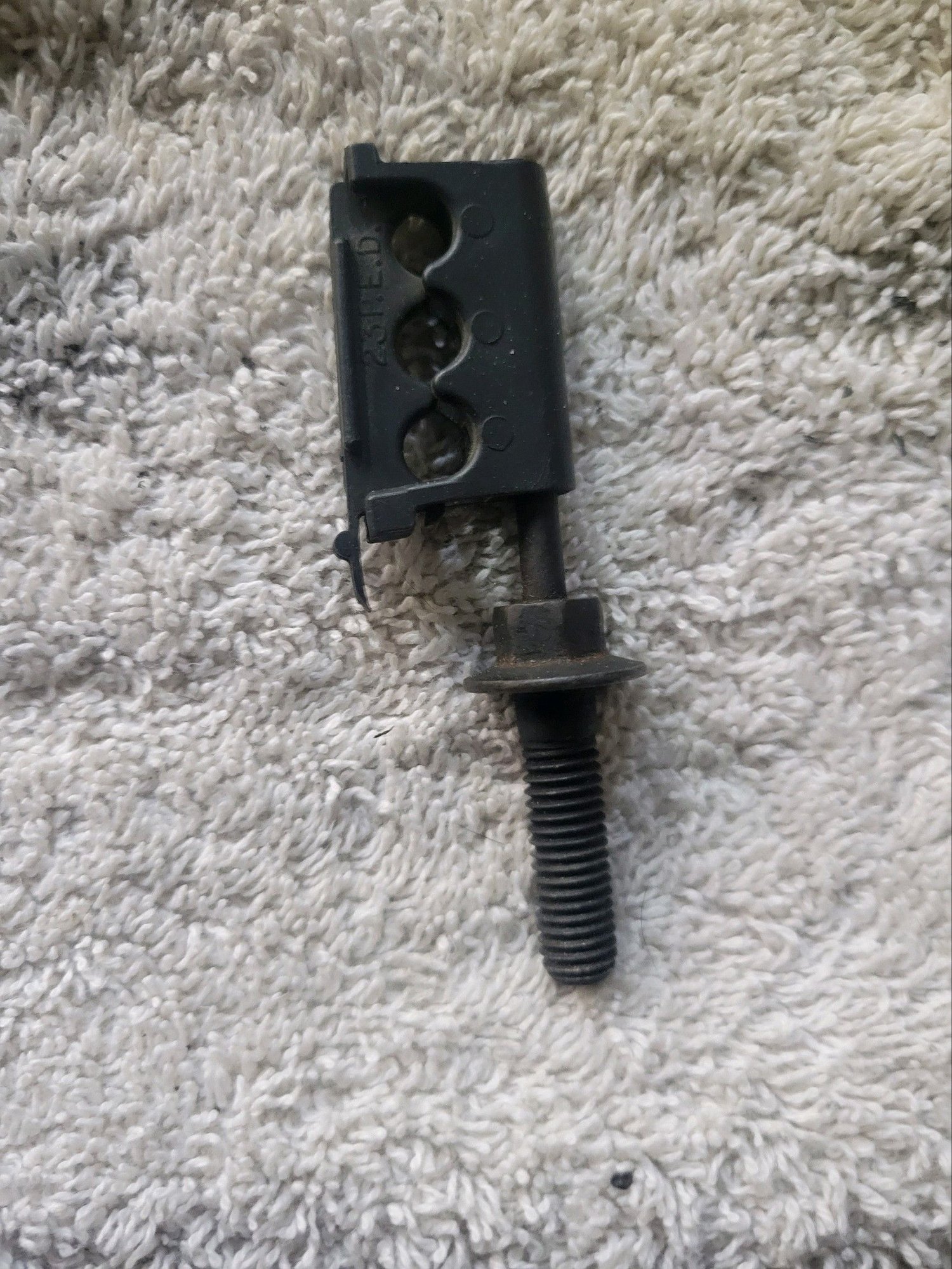

This is off my 85. Is it for ign wires or hydraulic hoses?

Good ole fashioned. ignition wire, locking retainer.

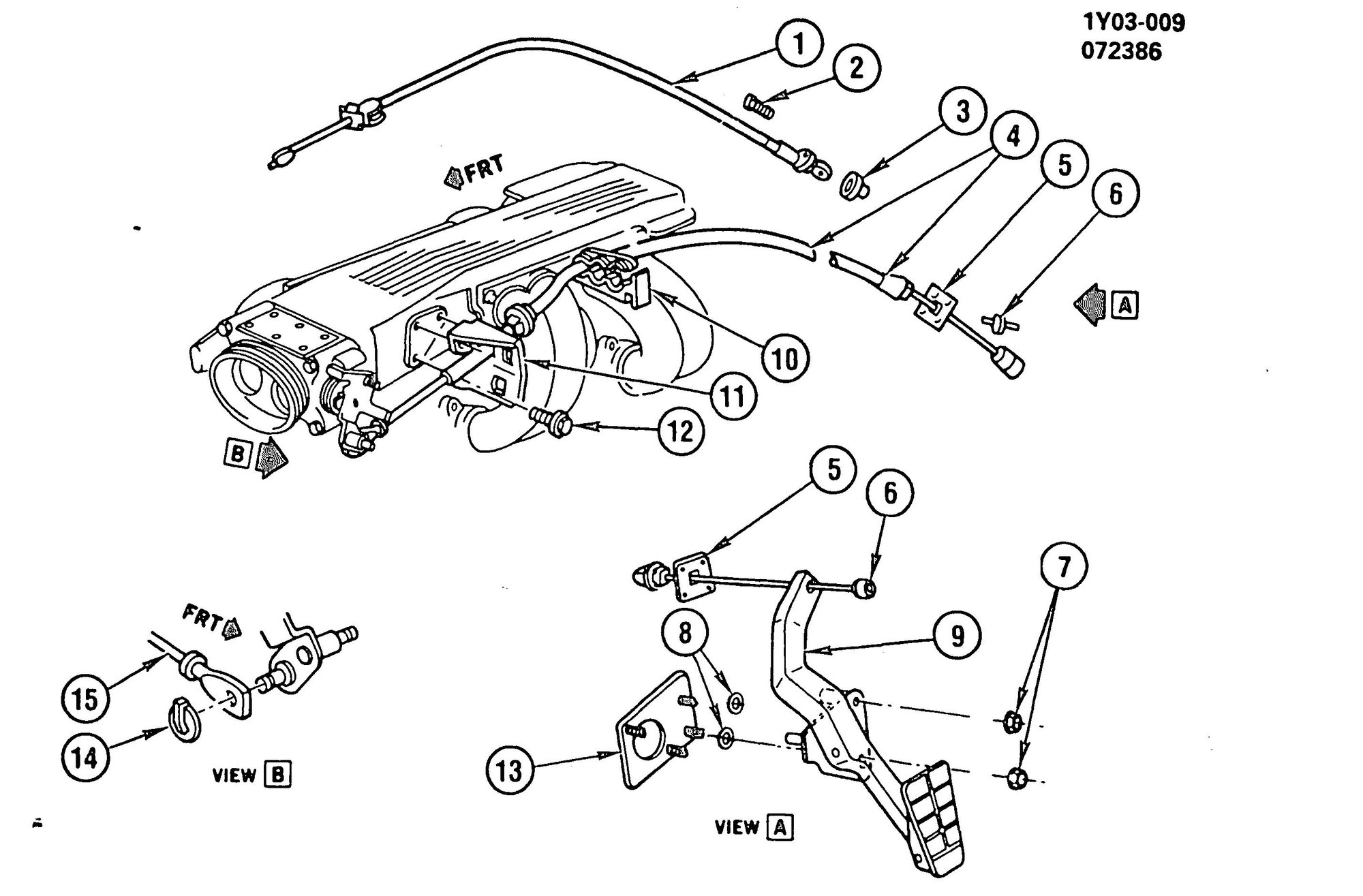

It actually could be/likely is a stud for the plenum tube and what appears to be a sparkplug retainer is actually for accelerator cable & cruise control cable.

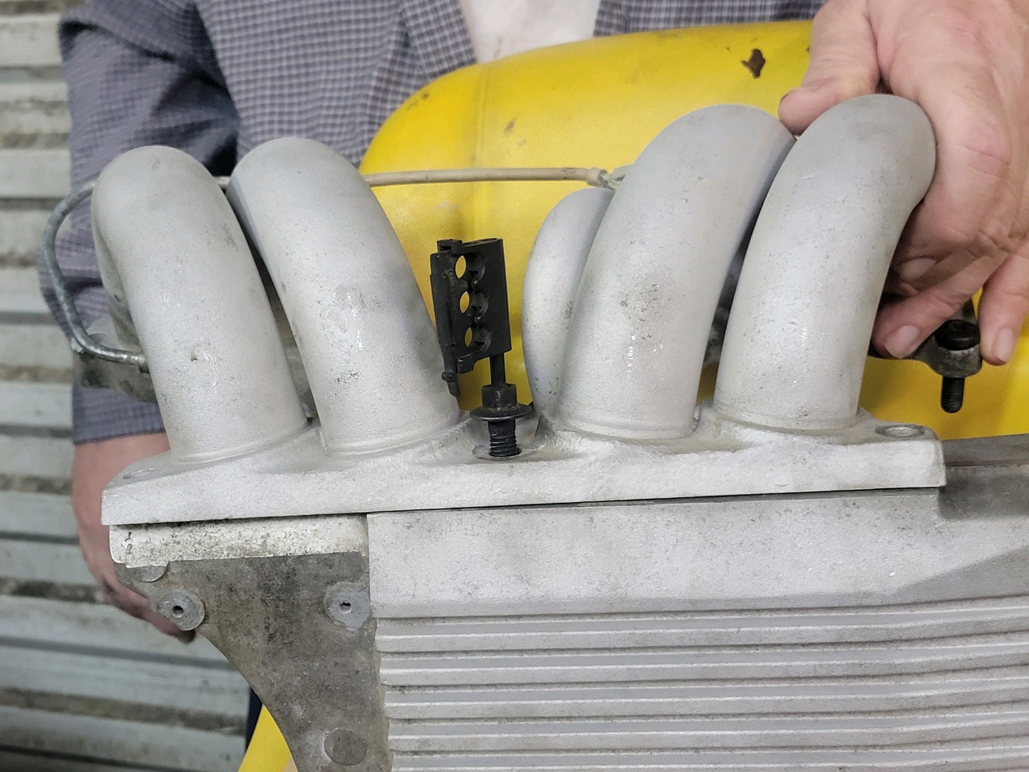

judging by the fastener where would it go?

2nd location I believe in the plenum tube to the plenum on the drivers side.

Drivers side. Dead center. runners/ upper plenum

WVZR-1, youre the man! Now installing it with the correct torque spec should be the real joy.

will be same as the other plenum/runner torx bolts

The plastic comes off that stud. You just need to pull it off. Then you can use a deep socket (10mm if I remember correctly) to tighten it.
