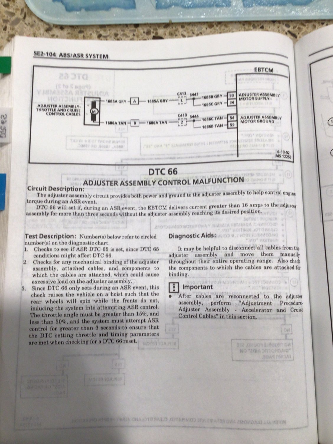

Just read the codes and I have a H66 in the abs module

DTC 66 is “Adjuster Assembly Control Malfunction “ make sure all the cables are not binding, I can copy the info from the Service Manual if you don't have one.

Here’s theDTC 66 check list. There is also a great utube video at Ozzstar Corvette, on adjusting the asr motor and cables.

Thanks for this info, I will do this when I get back to work on Tuesday. I did see that video that ozz did in asr adjustment. Is there a possibility that the asr cables being adjusted can correct my issue?

Not sure, but it might tell you if anything is binding. Had a DTC 65 code on mine, did try the reset, didn’t help. My issue was a bad EBTCM. Good luck, hope you get to the bottom of this.

Watched the video on asr adjustment from ozzcorvette. Performed the procedure this morning and it corrected my issues. Thanks again!
