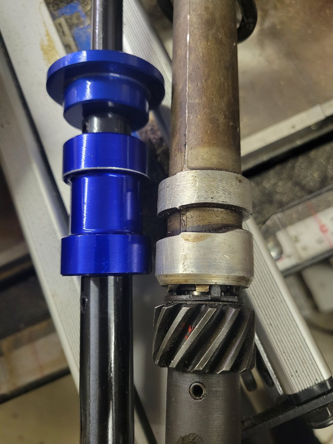

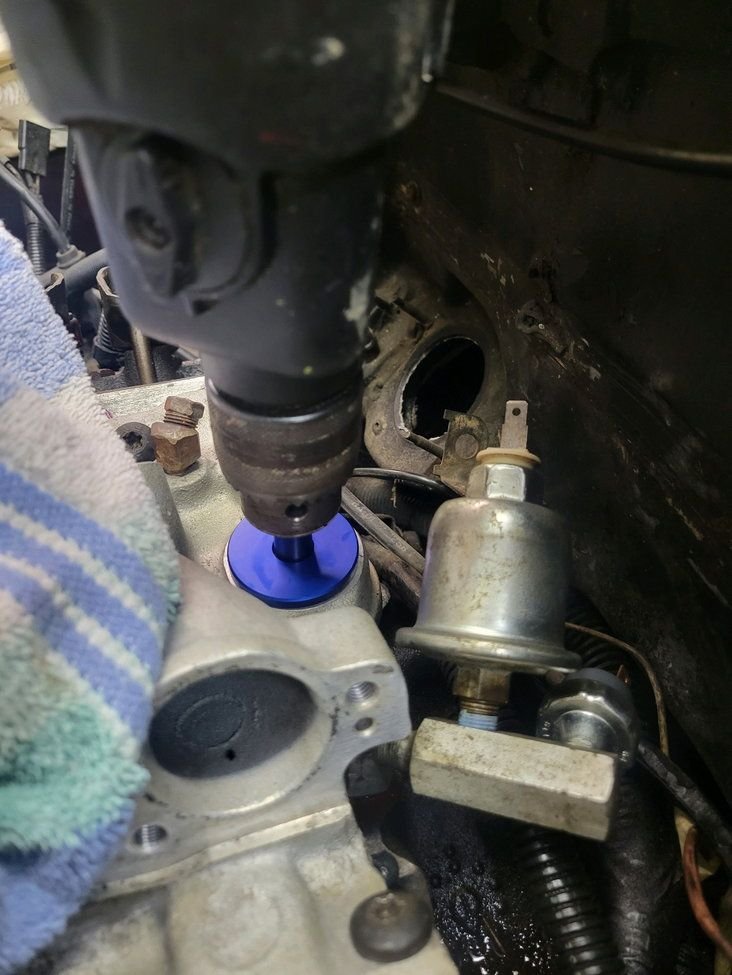

I have been trying to get oil up the pushrods via a priming rod but so far I can only get one rocker to squirt. The engine is a crate L82 4 bolt that has been sitting for 10 years. I am sure the lifters need pumping up but I already installed the intake to get the priming pump to fit correctly so I am kinda stuck. I have been turning the engine over with a torque wrench while using the priming rod and only one rocker squirts. The only other thing I can think of to try is to use the starter motor while using the priming rod. I heard that some of the priming rods are garbage and dont close off the passages correctly but I really dont want to modify my spare HEI to make another tool. The gear would have to be ground off and then something welded on top. Not my choice.

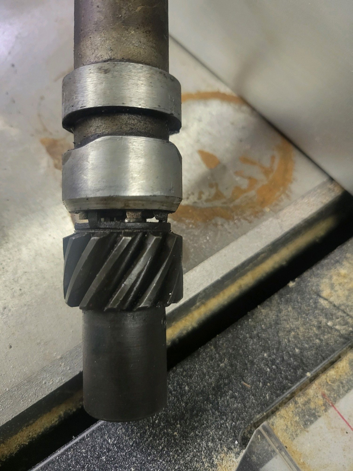

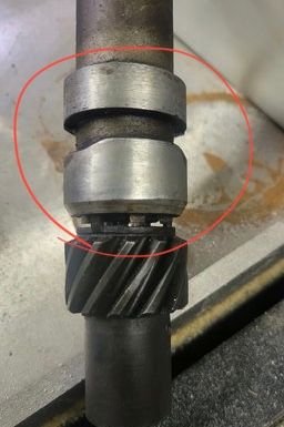

You are correct, if your priming tool doesn't have these 2 lands it will not seal off the oil passages that sends oil up to that one side.

My priming rod has those bosses but they may be loose. Would nice to see oil up there before i fire it up to make sure nothing is wrong with the engine. Now is the time to look at it altgough the intake is on. As far as pressure, its there with the drill on. Removed the pressure switch and it gushed out.

I dont think i can continue the engine build until i get all lifters to show oil. I used the starter and the primer rod, still only only rocker working. I did notice something on the primer rod spool, the diameter is the same but the spool is spread out vs the hei. Not sure if that spread could cause the galley not getting blocked off. I do have an extra hei but dont want to ruin it to make a priming rod. Its either that or the intake has to come off. Any ideas?

By chance can you switch the Distributor gear with the one on the priming tool ? If so then you could probably use the HEI to prime it with out ruining it. The last Engine I built I primed for close to an hour before I got oil to most but not all Rockers its been running fine.

I would start by removing the oil pressure sender - and hooking up a good old fashioned oil pressure gauge. Make sure that you are seeing a min of 30 psi with the drill turning the priming tool.
