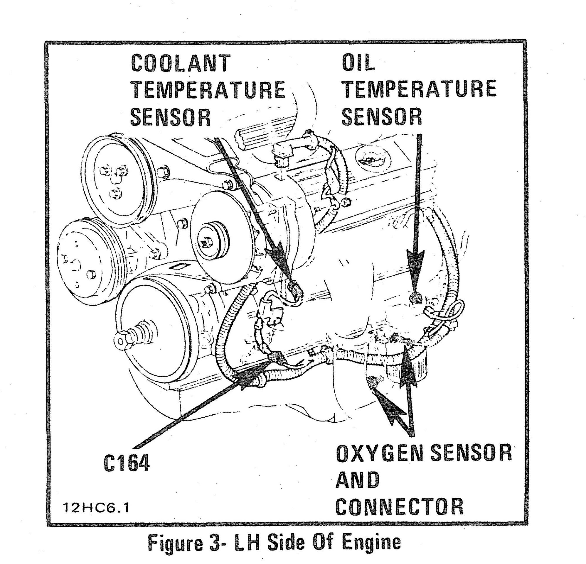

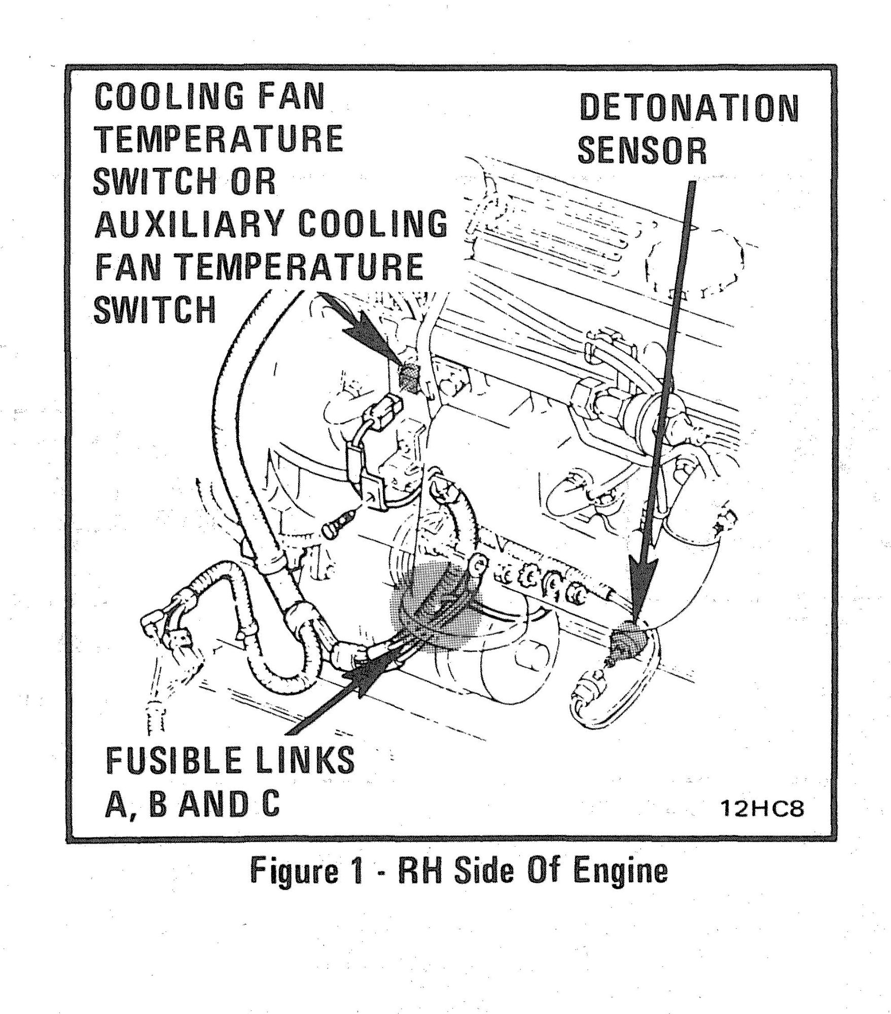

Originally Posted by THE 383 admiral
Engine/ gauge coolant temp
If he's using the '85 under-hood harnesses that sensor is meant to be 'left' cylinder head between 1 & 3. That location is a coolant fan switch in '85 OR if equipped with AUX Cooling Fan then it would become AUX Fan switch.

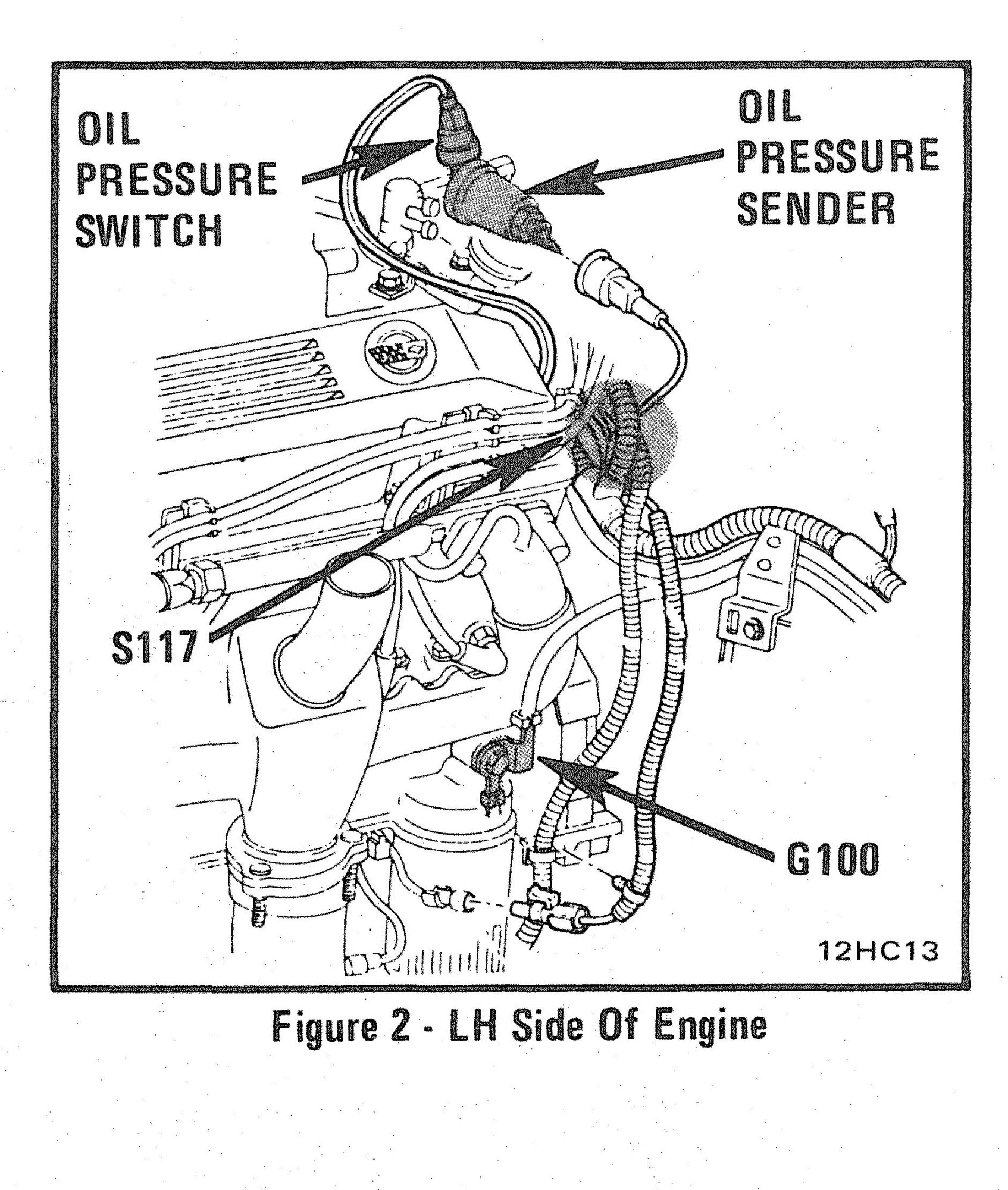

Originally Posted by johnfin
Not sure what you mean about underhood harness. This car has one large radiator fan and iam pretty sure the heads are original 85 heads. Someone just used the L82 as a short block.
From an '85 FSM and also it happened to be on the same page the FSM shows this orientation for the OPS you asked about a few days ago. You finally got the '85 EDM I believe so you should find these in it also.
