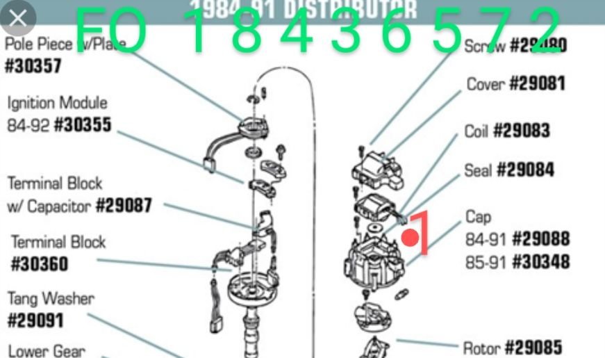

Where can i get these plastic parts for where the wires go thru the housing.

Simplistic resolution. Goop silicone. Or right stuff.

My 86 looks the same way. Searched every ware came up with nothing. Covered it with the right stuff. Never contacted them but Davis unified ignition sells a entire new hei computer controlled distributor for our cars. Maybe they got that wire harness with the plastic part that's cracked? Never contacted them about it. Felt that using the right stuff rtv would be just fine.

Don't spend the money with DUI, the only new parts are the are the module and pick-up coil. The hard parts are cleaned up junk.

you can buy 29087 which plugs up that hole but I need 30360. Not sure whos numbers those are but they dont look like GM numbers
