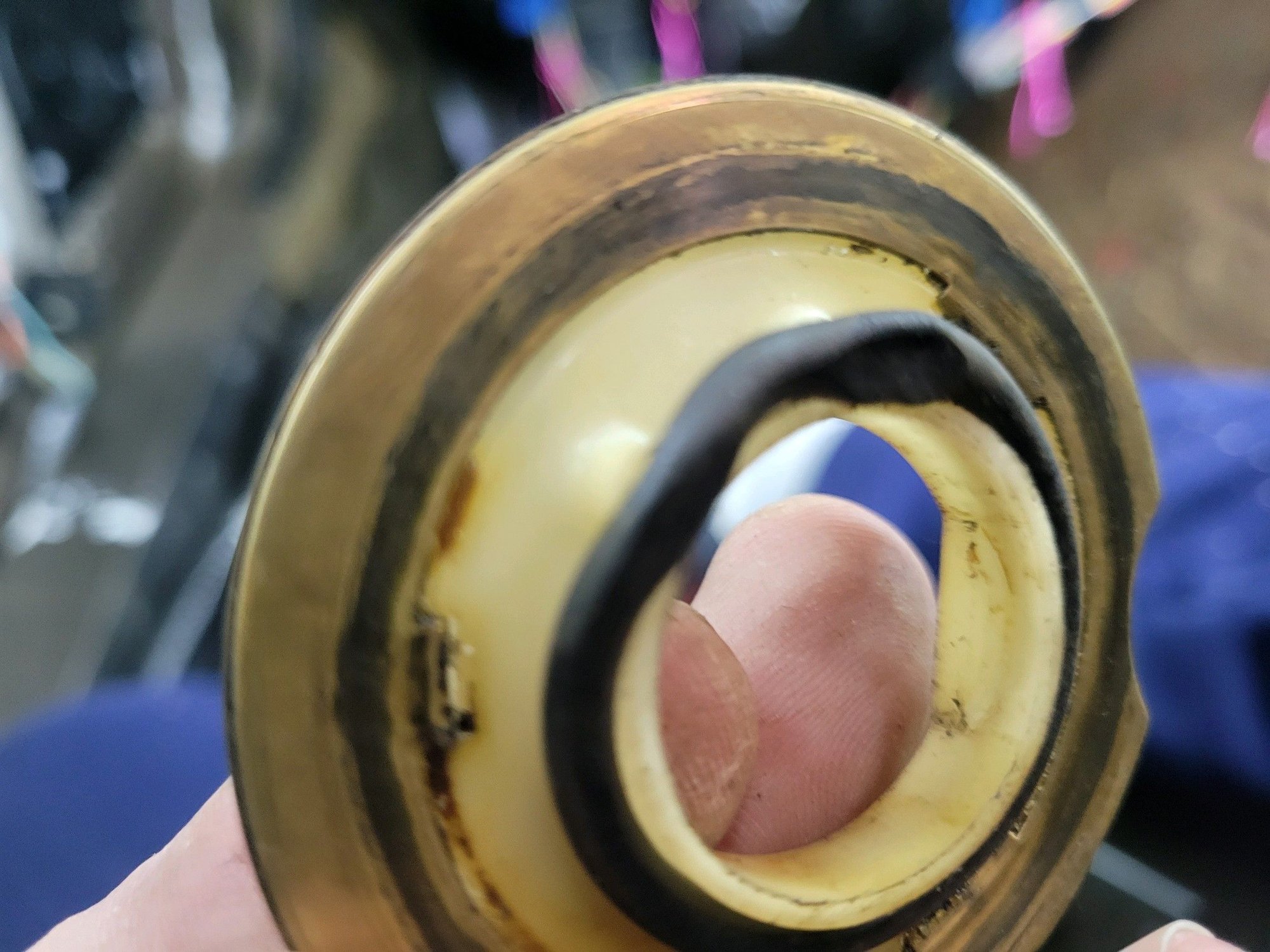

So I am at a point where I can remove the tumbler with one screw but I am afraid if I go further into it I may have a ton of parts and pieces all over the place. Anyone here do this job before and can advise. Also I noticed the plastic spring retainer has a seal like an o-ring but its smashes against to bosses. Did someone install it wrong? Thanks
