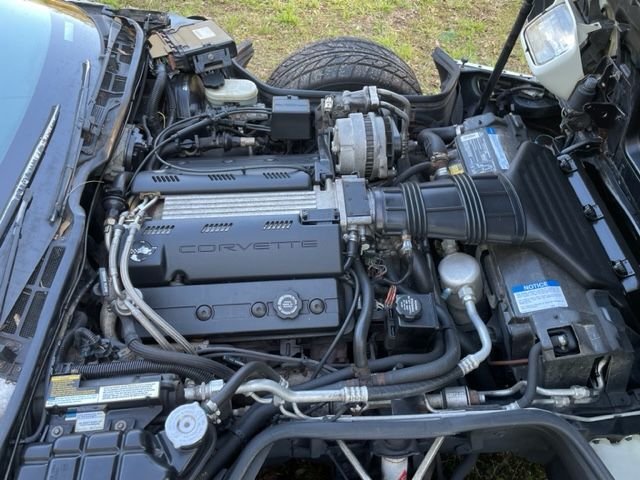

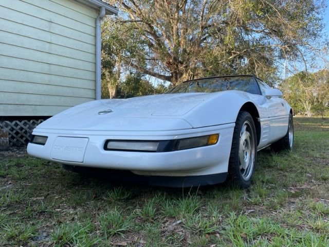

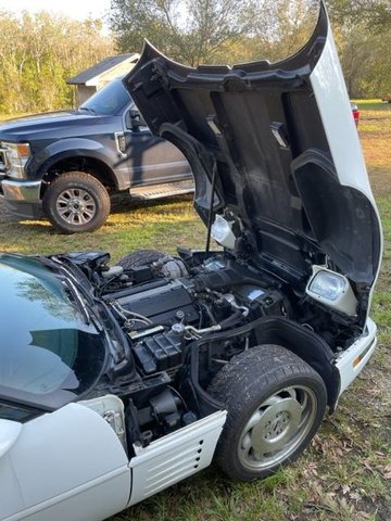

Hi everybody,
I picked up my first Vette 1993 C4 40th anniversary edition hatchback last weekend and I'm in love with her. The car is in pretty good mechanical shape, but there are some nuances, of course, that I would like to fix.
I apologize for a possible duplicate question, but I've been searching for any posts with the same issue, but I couldn't find anything...
The problem is that the ASR/Traction control button doesn't disable ASR and it's always on by default. ASR module seems to be working great and it engages when I try to do some sketchy stuff with the car It pushes the gas pedal back to me, retards engine RPM and shows "ASR active" light on the panel. Should I look at the switch itself first for a bad ground? Additionally, I've noticed that the lights on the right side of the hybrid gauges cluster are flickering or turning off, but when I move/wiggle the dimmer control it helps to turn the lights back sometimes. Does it mean that the whole dimmer control piece needs to be fixed/cleaned/replaced?
Any advices and recommendations are highly appreciated.
Another thing I would like to do is to rebuild the switches on the steering column... I'm talking about the high beam switch (I have no brights at the moment), turn signal/cruise/wipers handle, headlight dimmer switch and actuator, and headlight switch itself.
Weather strips is another big thing that I have to replace as soon as possible, because they all are falling apart and the floor on the passenger side is wet. Anyways, I already ordered those parts. So, I will keep myself busy during the holidays.
Here are some pictures of the beauty
Thanks!
