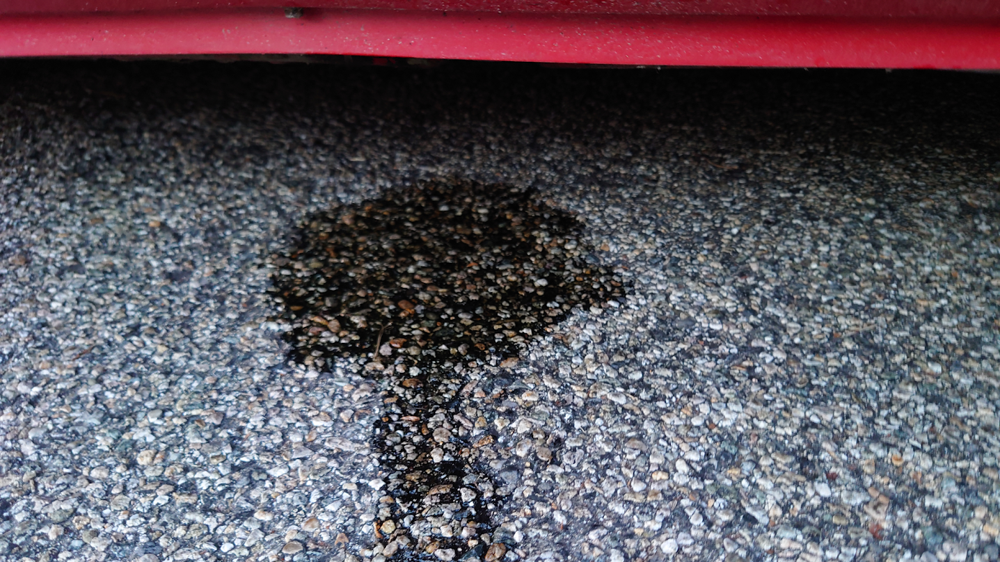

So, clearly there's something wrong here, so I decided to pop up the hood and check the master cylinder, like any rational car owner would... Well guess what? There isn't a single drop of brake fluid left in the reservoir, so the brakes have likely been pumping 100% air! That explains all the weird happenings, right? So, I promptly fill up the master cylinder w/ DOT 3 brake fluid and start pumping the brake pedal to get some more info on the situation. I instantly start feeling the previously-anticipated pressure and resistance of your everyday brake pedal again... But then, I start to hear a squirting noise--and I see this:
Brake fluid leak!
And that puddle of brake fluid explains the squirting noise from the spot under where I was sitting. I took a pic of what the underside looks like:
The squirting is between the black retainer and the identified droplet, seemingly from the retainer
This is likely the reason why the 'vette didn't have any brake fluid, thus causing the concerns with the pedal and lit warning lights. I don't know if this is some sort of bushing that I can replace or if I need to replace the entire front-to-back brake line, but any help would be greatly appreciated. Such as tips, experiences, lessons, or links/resources to buy this particular part (I don't want to buy the entire brake line set--too expensive for just one line)
