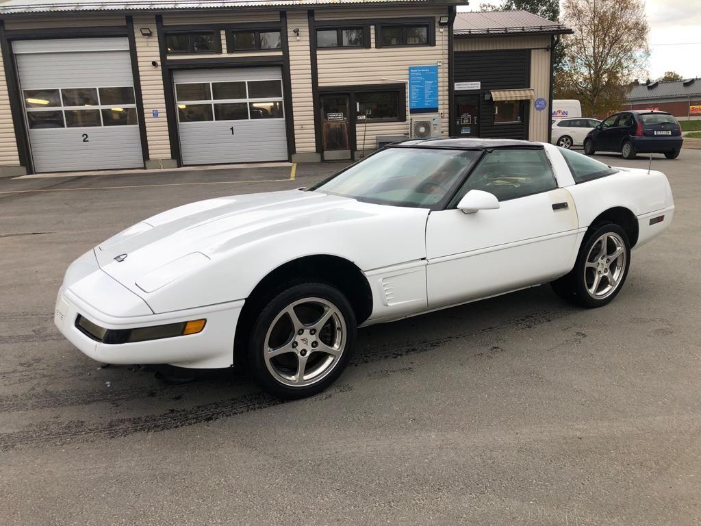

Hi
Here`s new Corvette fan with 1995 LT-1 project. I have rebuilt engine and automatic transmission outside of the car. Can I assemble engine and transmission back as a one package? I have no car lift available but jack stands only.
All advice is highly appreciated. This is my first Corvette project. I have the shop manual but it does not say anything about this. I did not take those out myself.
Without engine and tranny
