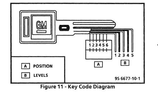

These are the mechanical cuts that I mentioned checking. Does the key # 'mechanicals' match you current key that works? 0A-8 in the FSM might help you understand. A is position on the key and B is depth of each cut.
